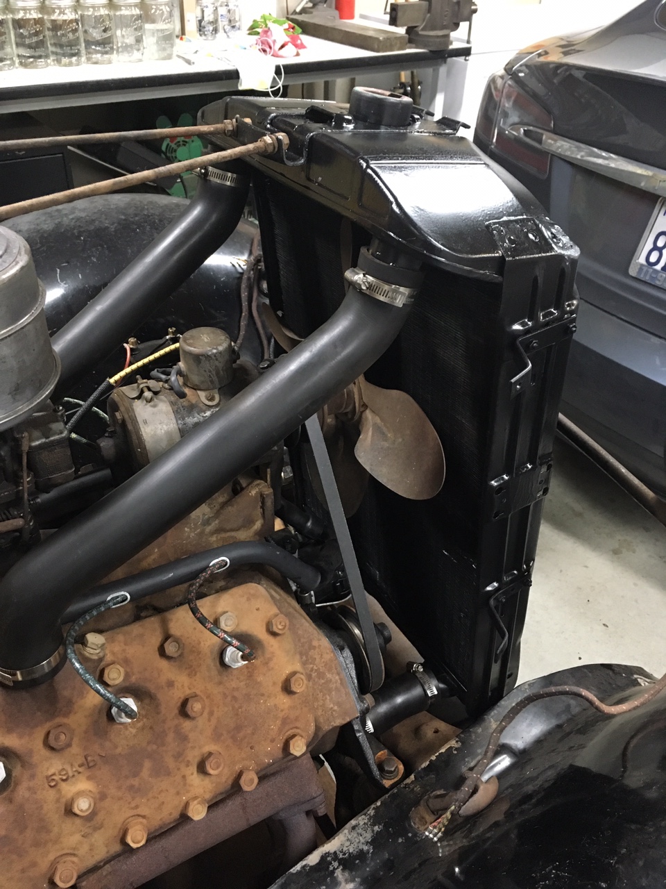

    It's still possible to get radiators recored or repaired here in the UK, although there are far fewer companies doing this work nowadays. This is the rad from my '28 Chevy Touring after it was repaired. It had been leaking from somewhere between the core and the bottom tank.
    Honeycomb cores are still being made here, but the company which manufactures them on a custom basis do most of their work for vintage aircraft where regulations mean that the original specification of components can't simply be changed.
    It's great that these parts are available, but you definitely will need to be sitting down when you ask the price; probably seems cheap if you are restoring a Spitfire or Hurricane, not so much for us. Anyway, my rad was stripped down, the core flushed through and flow tested before the rad was re-assembled and pressure tested; I was really pleased with the result which worked out cheaper than recoring with a modern style core.
