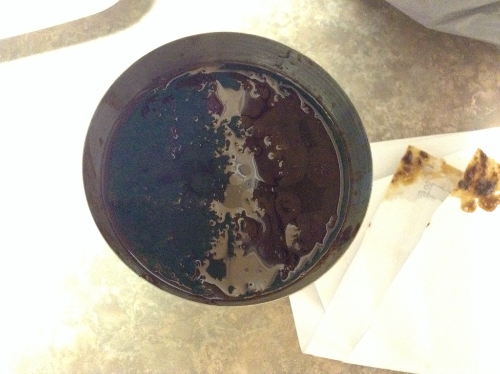

    ImageUploadedByH.A.M.B.1398121796.812908.jpg . Here is an aliquot of the coolant,

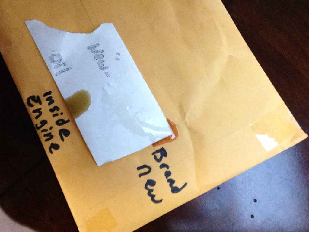

    ImageUploadedByH.A.M.B.1398122157.727154.jpg . This is what the engine oil looks like
  15. You need to see it in a drain pan really.
