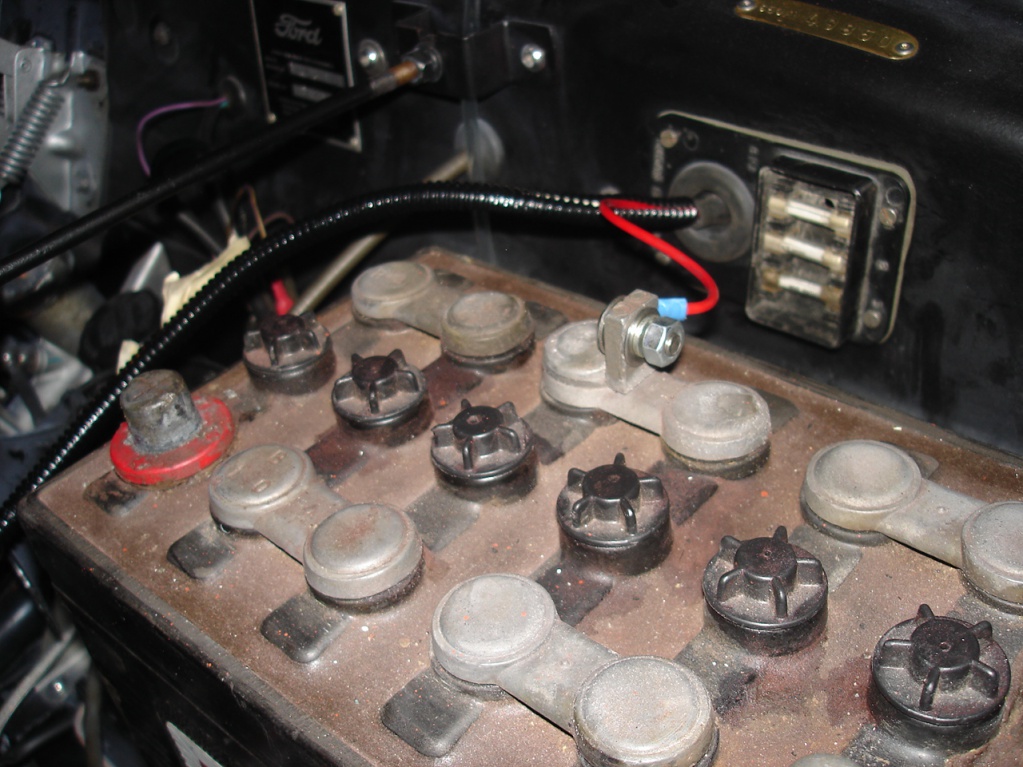

    Can you get this type of battery in the States. its a 12v battery with a 6v take off. You use a 12v generator / alternator to charge it. Wire it up right so that you use 12v for starting and connect up you 6v side to the 6v terminal 9 the one with the red lead. I have seen many moons ago guys putting a screw through the top a battery to pick up on the third cell for 6v
