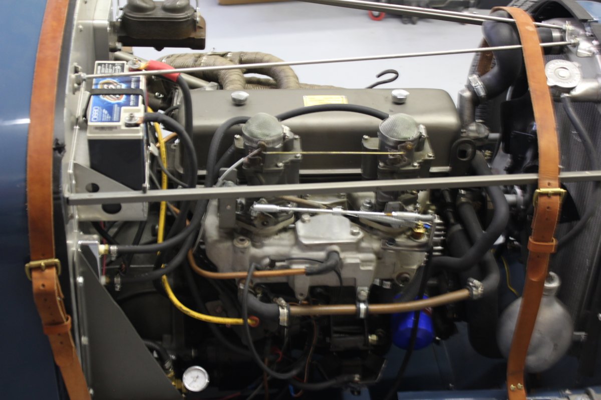

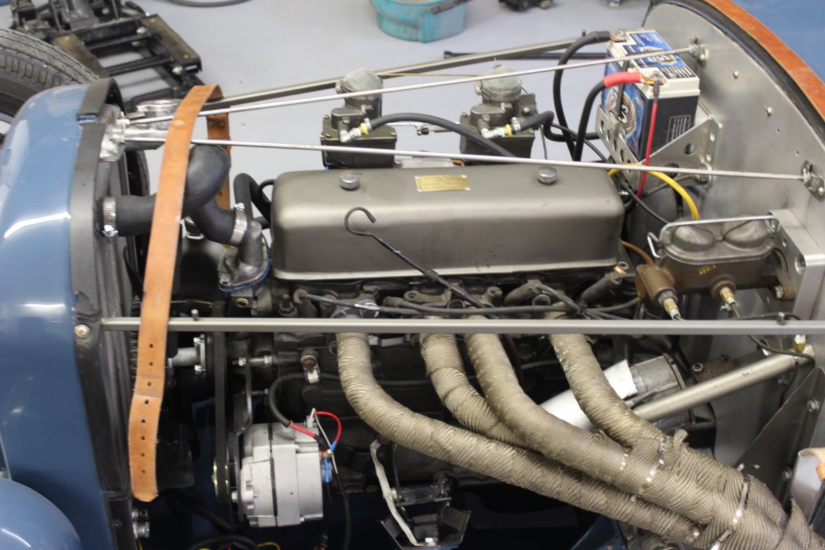

    There's a load of these out there. Just finding the right one is the trick. The winner seems to be the Penta from a marine application. I can't believe the following these little motors have! Just about anything from full roller cams to exotic heads are available. I'm actually excited about getting my hands on one. I can't believe the most desirable heads are off Hyster fork lift trucks. What!

    My gas tank came from an old Case combine.

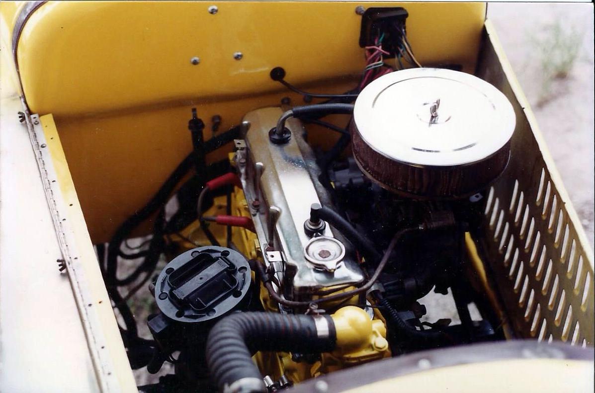

    The valve cover conversion in Charlesf's post is perfect. Alternatively, you could fabricate one of aluminum plate, grind down the corners to a radius, and lightly sand blast so it looks like a casting. You could mill a name on the top, like Frontenac, but I personally have a little trouble faking things. Don't know, but I suspect a repopped oldie valve cover would need major surgery to fit, unless designed specifically for Iron Duke application (see my previous post above for the issues involved).
