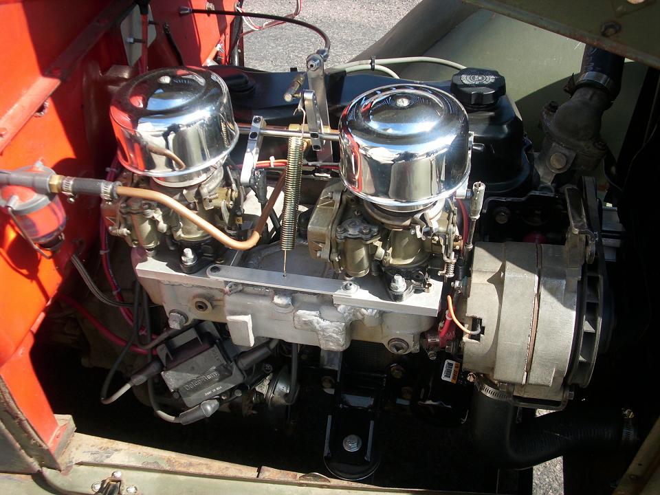

    Got a couple pics of an Iron Duke in a model A that I just saw yesturday. I took couple pics. Don't know what intake is but he had a couple holley carbs on it. Looked pretty cool to me

  17. did you take pics?
    I would love to see some.
    thanks
