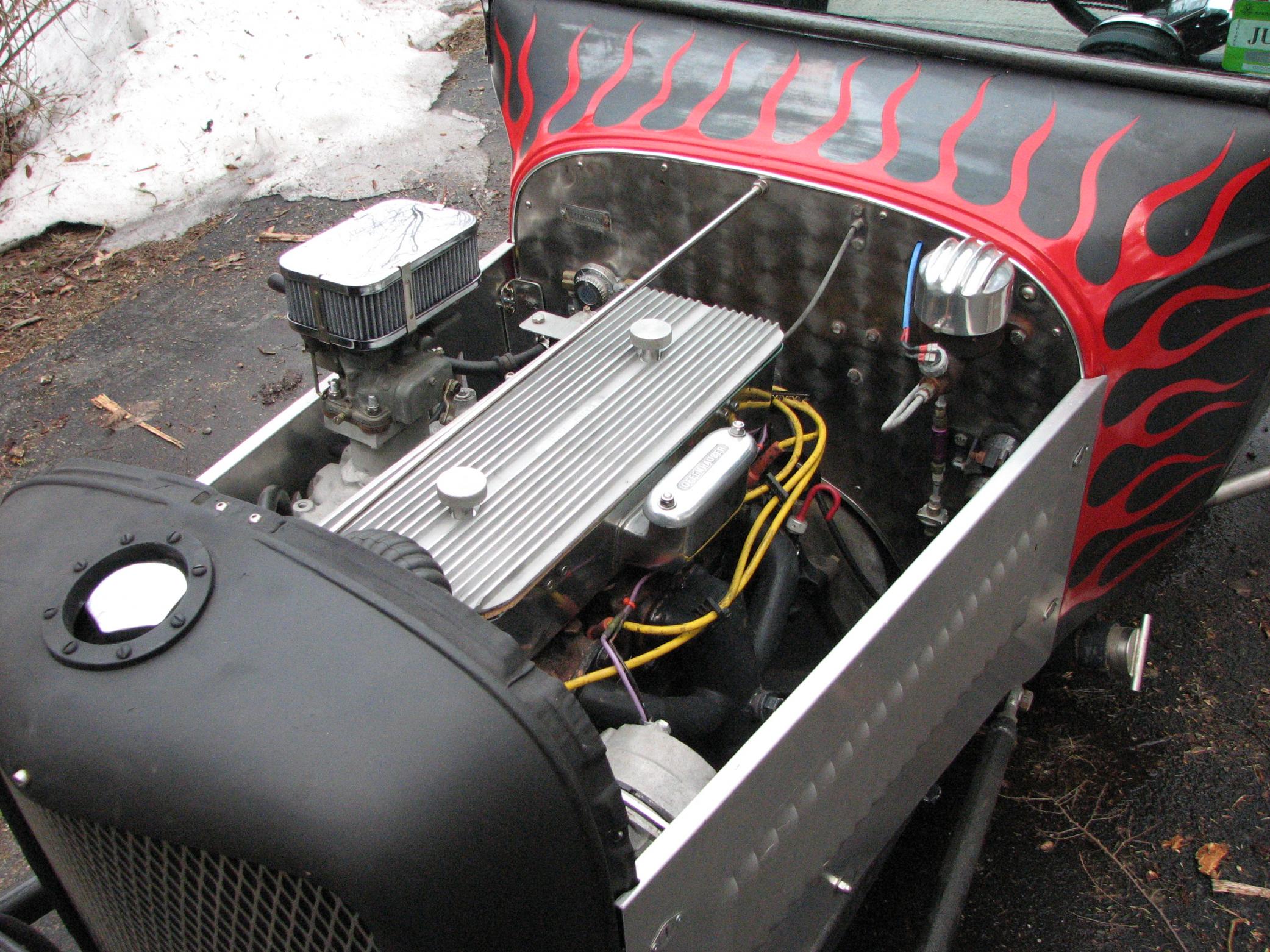

  16. wizzard23
    Joined: Dec 12, 2009
    Posts: 733
    wizzard23
    Yep, ModelAVette has alot of good info on the history of these motors. I've got one in my Track T. I started out with a 153ci ChevyII that I ran for several years till it developed a crack in the block. I then came up with a 151ci Pontiac from the mid 70's, had intake and exhaust on the same side like the Chevy. Those Pontiac manifolds were UGLY. Figured out the Chevy head would bolt on so I could use my smoothed and powder coated manifolds, so went that route. Also had to use the Chevy cam ( I think fireing order is different, can't remember for sure.) Anyway, been running this combo since 2002 0n a car that gets driven with good luck. I have a few Chevy heads but they are cracked, so this may have been a common problem on the early ones in dailey drivers that got little care.

    Here's a shot of the Weber carb, mounted to a stock manifold. Made a base,and short duct to attach it in roughly the stock location and tigged it on. Carved the interior out with a die grinder to sort of match it up. Works nice, and the stock manifold is heated as well. Have seen several other similar conversions on a stock manifold, with Holley flanges etc.
