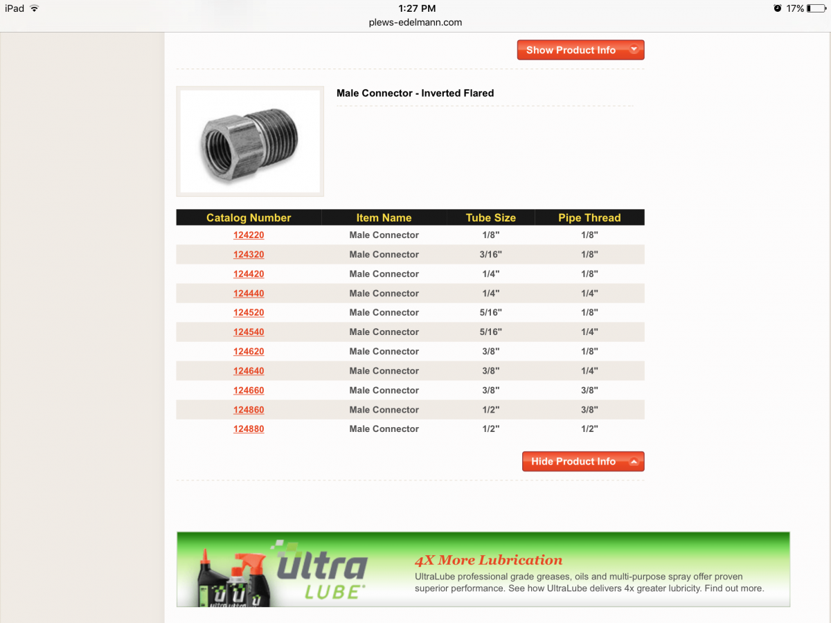

    i am having to run an electric pump because i'm running a newer sbc block with no mechanical pump provisions or pushrod hole.
    1) Can i run a "regular" NPT fitting from the pump outlet? i can't find an inverted flare in 1/8" size.
    2) Just out of curiosity, and somewhat tied to the original question, can you run a regular npt fitting instead of an inverted flare fitting off the outlet of a stock SBC mechanical pump?

    Yes, it probably will leak. But the specs for that pump say it's an NPT fitting.
    NPT threads are tapered. Inverted flare threads are straight.

    1/8-27 is the same as 1/8 NPT.

    i'm thinking they most likely ARE npt----and i see everyone one on youtube who uses this pump using npt fittings with no apparent problems. i think the thing that is throwing me off is there appears to be an inverted flare nipple in the outlet (or maybe it's something else?). Will try to post a pic tomorrow.

  10. That is Not a Gasoline Fuel Pump. It is a Lift Pump that is designed to supply fuel to the high pressure pump in a diesel. The fact that it is rated for gasoline does not make it a good choice for a gasoline motor fuel pump - they do not recommend this pump for that application.
    and 1/8-27 int IS 1/8 NPT
