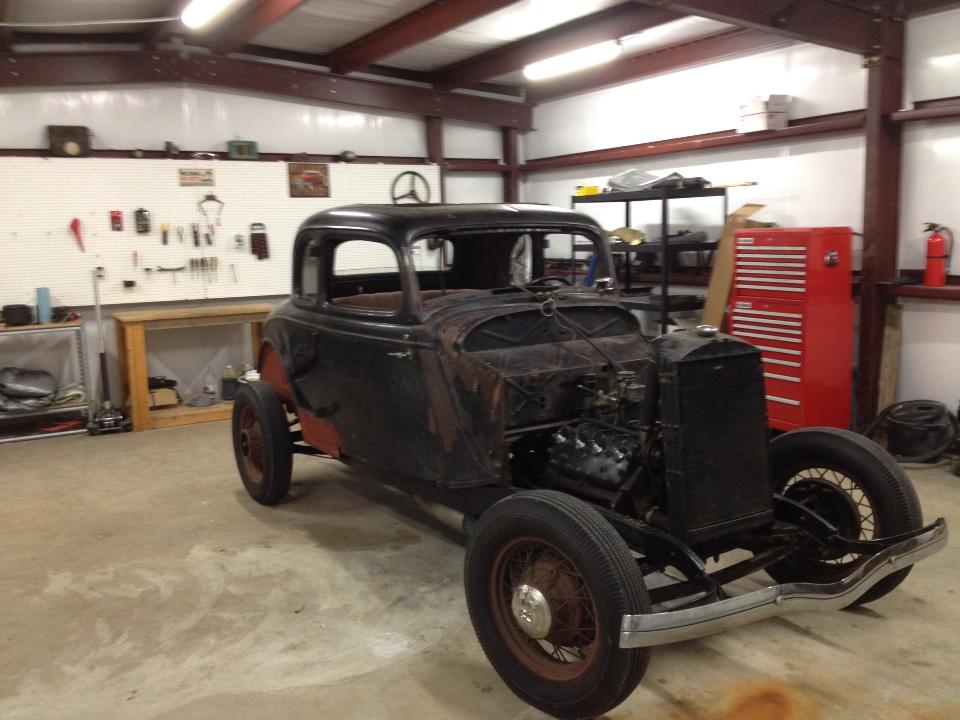

    Many people have stated to flatten the rear crossmember. That might be ok if you were still in the initial phase of building, but you aren't. So I'd suggest that you just try a reversed eye rear spring with a few of the leaves taken out to see if that gets you to a height you like.
    For the front, you should get a dropped original Ford axle (or have yours dropped) from any of the guys that are doing them. You should also get some '37-48 spindles and have the arms dropped the needed amount. Maybe the axle dropping guys can do that for you too when they do the axle.
    Reverse the front spring eyes and remove a few leaves.
    Don't split the front bones.
    Use a "hoop" steering arm.
    Run '40-48 brakes all around.
    Use '35 wires all around (don't forget the special adapter rings needed for use with later drums).
    Use your stock '34 steering box unless it's not rebuildable, then use an F1 or F100.
    Keep the stock 21 stud & 3 spd trans until you can build a nice 24 stud and '39ish trans.

    You can get a lot of lowering done just with the springs. There are tons of threads with guys showing how they did their reversed eye main leaves (lowers 1") at home with a cheapo Horrible Freight 20 ton press. Then you could probably remove a leaf or two from the front for a bit softer ride. And you could adjust the height a touch more by taking a bit of arch out of every leaf (lowers another inch or more).
    My 32 sedan has a stock rear spring (including all the original leaves) that has the original main leaf, not reversed. The leaves are slightly de-arched. It has about 2.5" before the axle hits the rubber bumper. You could go lower if you can stand it. It's a weekend job to remove the spring, do some de-arching in the press, and reassemble. Sneak up on it, and change it if you need more.

    I'm going to start with reversing the springs and go from there. The main question I am mulling over right now is if I should stay with the 17" wires or find some 1935 16" ones.
    I have basically scratched the T5 option. The Columbia is an option.

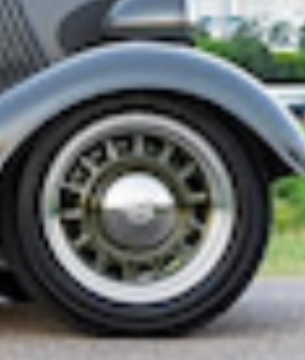

    What width are the 17" rims? I think the 16" are 4" wide.
    Stogy likes this.
  18. 17s should be 3.5 inches wide
    you can widen them if desired
    a lathe and good welder, the wheel kid (hope thats correct) can do that. dont know the pricing
    Stogy likes this.
