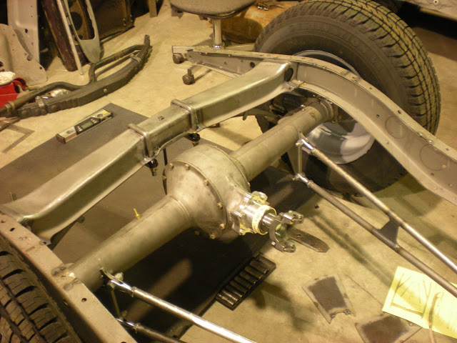

  2. [​IMG]
    I'll go out on a limb here and say this is a good example of what Not to do. I understand the Model A spring with the Quick Change. Had this been done with Spring behind the housing instead of on top there would be no need for the Large kick in the frame that leads to major floor work.

  4. I don’t like the big kick up either. Just the best example of a model a x member I could find in a hurry
    It also shows the front x member

  5. anthony; What would you think about him just doing a light snip to the rear crossmember and raising the center 2 or 3 inches and leaving everything else rear Axle related as is?
    Stogy likes this.
  6. That’s how I’m told the old guys done it back in the day.
    If I were building a trad style 33-34, I think I would modify both the front and the rear X members and use reversed eye springs.
    But I would want it all assembled with the tires I’m gonna run before any mods would start.
    If all ya need is a 4 inch drop in the front a flatter x member and reversed eye springs would accomplish that with out modifying the front axle.
    Modifying the rear x member is the simplest method to lower the back of one of these in my worthless opinion
    The model A x member would be used for a severe dropped fenderless car only for me.

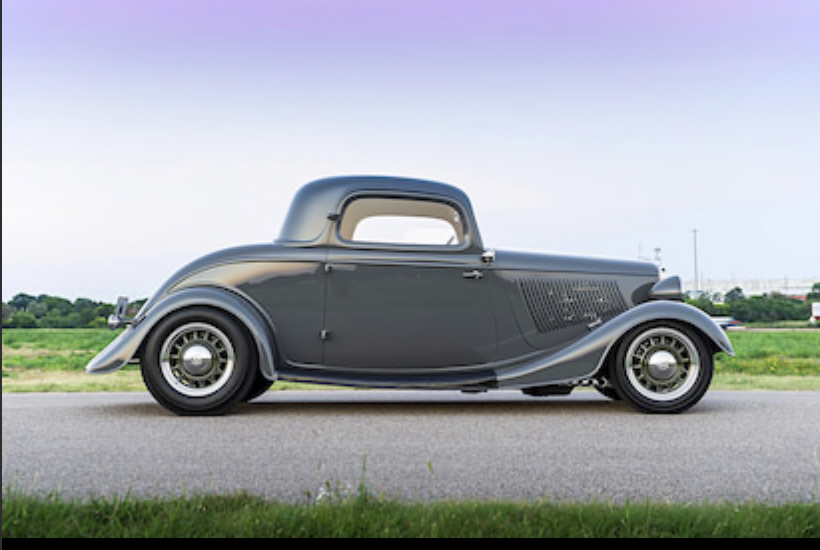

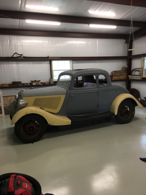

    This is the stance I want:
    Here is the car mocked up before paint
    The wheels are original 17" wires. I am thinking I need to go with 15" or 16" wheels to get the look I want. Whatcha think?
  20. The issue with the 17s for me is how narrow they are.
    The 16s and 15s we had on a ride at work were perfect but the 16s were widened and the 15s were 16s that were modified. Not a cheap route
    Look up Coker tire, wheel vintiques, and the wheel smith

    I like the stance of the car as it was before paint, wouldn't change a thing. The paint color is awesome, is it a vintage Ford color?

    Its not a vintage Ford color but I think it looks vintage. I considered going with black but found this color right before going to paint.
