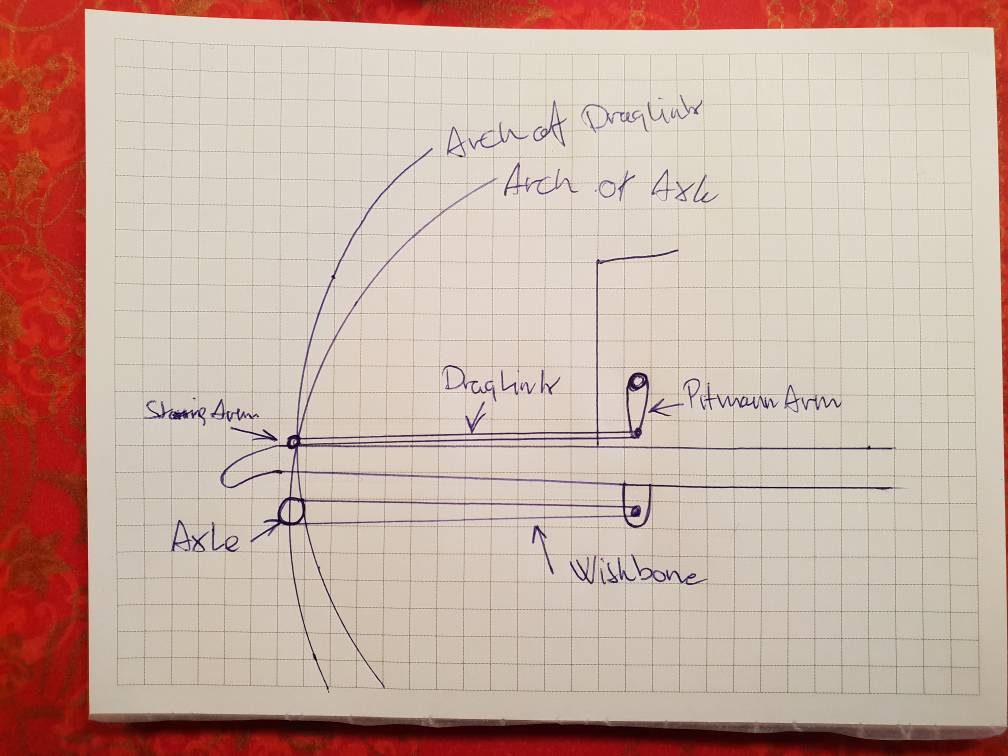

    I am hoping that comments do not discourage you from building your rod with cowl steering. There is no mystery to the geometry of bump steering free operation with cowl steering. In these photos notice the length of the drag link in relation to the steering link length. When these are equal they move in the same arc so as the wheel travels upward over a bump the two links move in a identical amount and the tire does not deflect side ways. Can't wait to see next progress photos. 0cbc69d0740fc507b766e3c1bae6a902.jpg 6acfee7fe19795fa22affbf9fdd6aa1a.jpg 20160803_205052.jpg

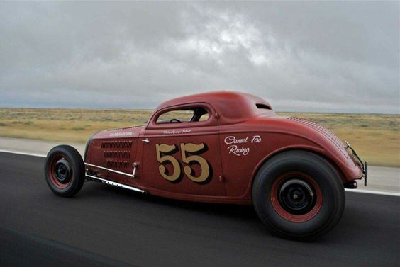

    Thirty two, your comment contains no factual info, just an opinion. I am waiting for you to back up your statement with facts, logic and cogent discussion. The car in the first photo runs at Bonneville which can be a rough and bumpy ride in certain conditions. Review your geometry text.
    Sent from my SM-G960F using The H.A.M.B. mobile app
  7. to get those arcs the same you would have to have the pitman arm a lot longer and down near the wishbone pivot....just saying. I have cowl steering on my project but am committed to finish it even though I fully realize that I will change to cross steering in the finish project before paint. Just have to see for myself what amount and how bad the bump steer will be for my own education:rolleyes:
  8. Kedde
    Joined: Feb 1, 2007
    Posts: 61
    Kedde
    from Denmark
    Exactly.!

    First pic of what car? That rolling bones 3w?.., may have been at Bonneville but that is no Bonneville race car
    Facts, logic science ect, you should do your homework , all you had to do was open up Pete Eastwood’s thread and educate yourself, there is even cool working videos with music to watch
    If you want you can also do this in a backyard manner with a couple yard sticks and nails
    And see the different radi
    The only way the bullshit you spewed in previous post would have a chance at truth is the use of 4bar system
