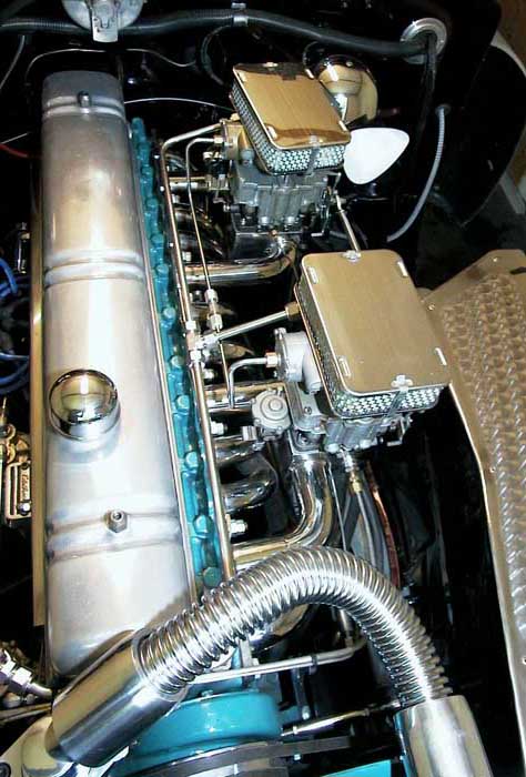

    Has anyone successfully built a multi car intake for a 248 Straight 8 Buick? If so, would love to see some pictures and some details if possible. Thanks! Gary

    I saw an Edmunds dual carb setup for a Buick on THAT auction web-site during the week.

    Find the Buick 8 powered Great American Race car Coker ran a few years ago - nice 4 - 2 setup

    I've been looking for the Shafer 8 that was in the Coker car. So far, all I can find are outside pics. I don't suppose you have a link handy? Thanks! Gary

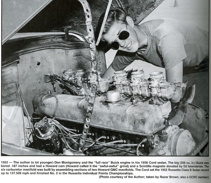

    Duals were made in '41 and '42. I believe they were made for the 248, 263 and 320 engines.

    Chub Chub: Now that's what I'm looking for. Where did you get that pic?

    That's Don Montgomery on the left ... he's one of us.

    I'm not reaaly sure where I came across that picture. If I had to guess, I would probably say I found it on the HAMB or team Buick website. There are three pics of Don Montgomery's Buick powered Hudson in "California Bill's Chevrolet GMC & Buick Speed Manual". There are two pics of the straight 8 with 4 Stromberg 48's, and one pic of the exterior with "the owner" standing by it. The pictures are sort of small and lack detail though.
