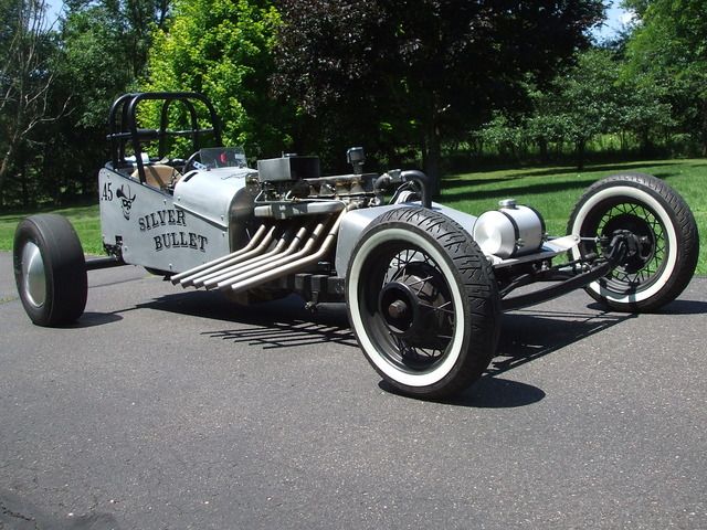

    I've got a Holley 3310 750 cfm with vacuum secondaries on my 300 Ford 6 (pictured above). While I have not achieved the maximum performance out of my dragster yet it appears that it likes the carb.
    Down the road I'll make a two carb manifold to see if better fuel distribution helps on the straight 6.
