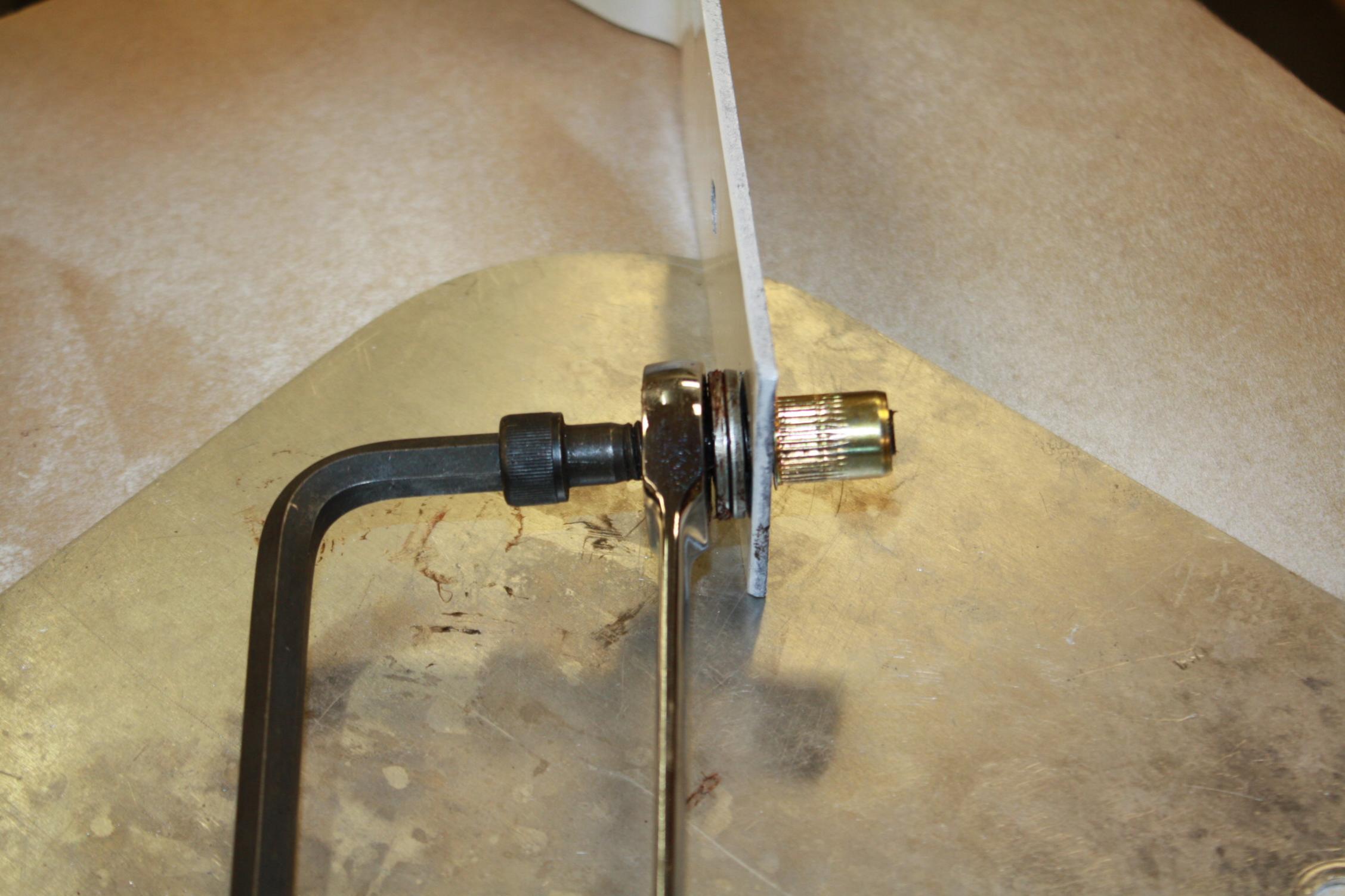

    Home made tool, works well. 1/16' metal strap with drilled hole, gr 8 allen bolt, nut and some washers. Grease the washers. Hold allen wrench and turn the wrench.
      275.7 KB
      3,102
      255.7 KB
      8,799
