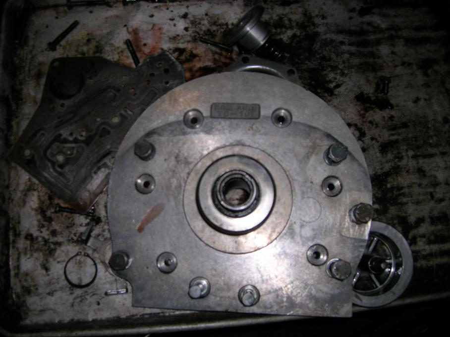

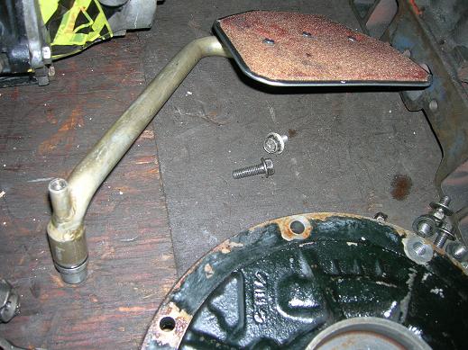

    Here's some pics of my Clutch-Turbo 400. AFAIK, it's the first being built in maybe 30 years.
    The input shaft is unique with a very large end. I need to make a custom pilot bearing for it.
    It has a full manual reverse valve body. Note lack of governor.
    The case has the bellhousing milled off, with a B+M front plate to mount a scattershield.
    The 3-prong part on the shelf is from Winters, the first new one made. My trans came with a broken one.
    The filter is a Chrysler unit. Old trick racers used. It is a much better filter. You mount it by doubling up on O-rings, and adding an extension to the mount that butts up against the pan.
    The pump has many unique small parts, note the strange drive setup.
    It will be run with no trans cooler, just a loop, with no converter there will not be any heat buildup.

    An automatic uses planetary gears and hydraulics to shift. I have already removed the parts that cause slippage between gears. This will create immediate gear changes under high pressure.
    1. Gears are much stronger than cog gears.
    2. Impossible to miss a shift.
    3. Hydraulics create super-hard shifts.
    4. Dependable power-shifts.
    Back in the day they were called a "poor-man's Lenco". You cannot shift a traditional manual trans as hard as one of these. They are very hard on drivetrain parts.

  14. Crosley, you're the man on transmissions, but for the others.The three finger part in the first post hooks the pressure plate to the to the pump. so the trans is at pressure at launch and these clutch-automatics run with double disc clutch's to absorb the shock of the launch. I also like the Idea of hydraulic throwout bearing with a bleeder valve. works like a line-loc, except it times the release for consistant launches at the strip
