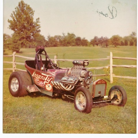

    Isn't Rudy Petra's '23 called the Insani-T? Since back in the late 80's?

    That was Rudys fuel altered was it not?

    Not sure but mybe this is it.

    Yes, I have a couple of his T-shirts around here somewheres. He and my father-in-law go waaaaaaaaay back.

    If pic above is the car it is a roadster, my build is a coupe and Spelling is different. Mine's a street rod not an Altered. Don't think there is any chance someone would be mistaken on which car is which.
