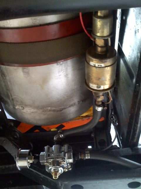

    I took this (used to be) cheapy one of my hot rod that was on there at least 6 years,
    and put it on the 40.
    It works great but they were $15 now they're $30.
    There's a number dial 1-5 but I'm not sure if I'd trust that as the actual pressure.
    This is the Holley one I got for the 40,
    but it was so big I couldn't fit it anywhere without rerouting the lines.
    I also needed adapters to reduce it down to the threads I needed.
    Make sure you get the LOW PRESSURE version,
    some are made for 1-6 pounds and others from 5-20 or something like that.
    This was an ebay deal for about $25 and works great.
    I'd get a fuel pressure gauge so you're not guessing the pressure.

  10. bgaro
    Joined: Sep 3, 2010
    Posts: 1,189
    bgaro
    i'm running the edelbrock version of the second one zibo has pictured. it was pricey, but works well. also if your gonna run a guage remember its most accurate in the middle of its range.
  11. 1968pickup
    Joined: Oct 20, 2009
    Posts: 141
    1968pickup
    from ND
    ordered one like zibos now what to set it ? at what is the ideal pressure for a one barrel 1904 this is a stock engine just need it to run good not a high performance engine I will just be happy when it runs and doesn't leak fuel!!!!

    I am using a regulator like zibo has pictured. It is on a 3/8 fuel line mounted on my firewall along with a moon fuel pressure gauge that is liquid filled. The 383 sbc has no provision for a mechanical fuel pump so I use a carter electric fuel pump mounted near the fuel tank with a fuel filter between the tank and pump. I run 5&1/2 lbs of pressure. the moon gauge gives accurate pressure reading all the time. Been using this set up for 16yr. now with good success on a Edelbrock 600 cfm.....................
  16. I'm using that Holley one pictured. Works great I've had no issues and is easy to adjust.
