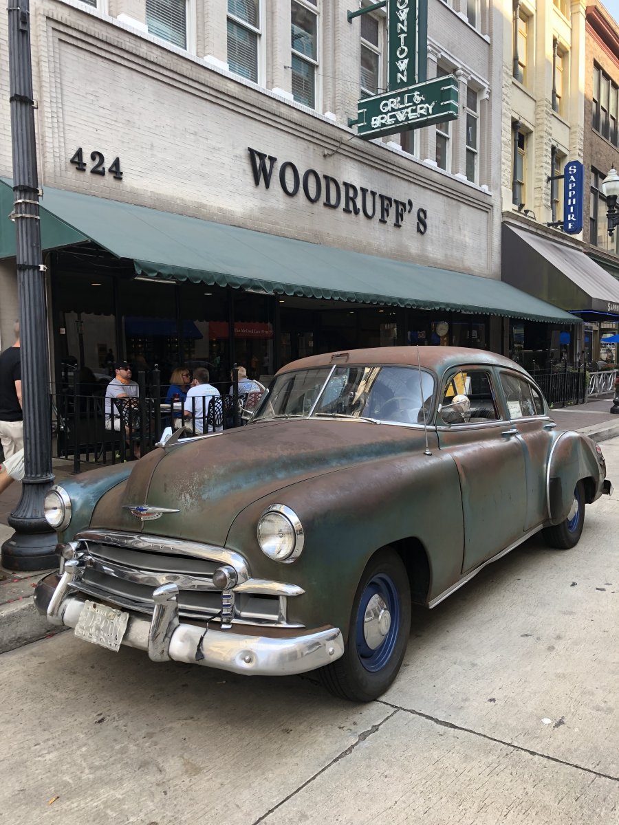

    3E31F190-EA1E-4893-AC4B-8A5AE4086D8F.jpeg I lean more toward leaving well enough alone and drive it. Take the two lane highways and enjoy the drive. That’s a very sharp car! Mine is still a 216. You could change rear end ratio easily with gears or complete rear end from an automatic transmission car.That would boost your top end speed. ‘51-‘54 will work.
