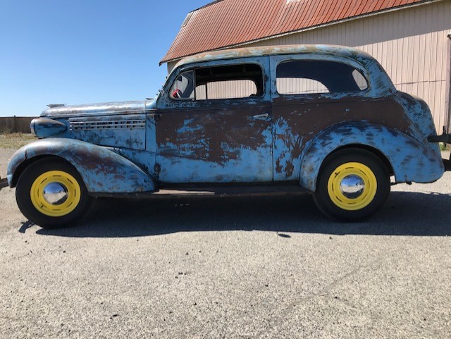

  14. A guess it depends what you want. I put a 235 in my 38 with all original running gear, bellhousing exc. I also have 3.55 rear gears in it which makes it a bit better. Haven't had it on the hwy. yet.
    Just got it on the road and drivin around town. Am already thinking it would be nice to put a t5 trans in it and put a chev 6 bolt rear.
    But for now will just keep it the way it is and fix what I have. In the meantime enjoy and look for parts. thumbnail_IMG_0125.jpg
