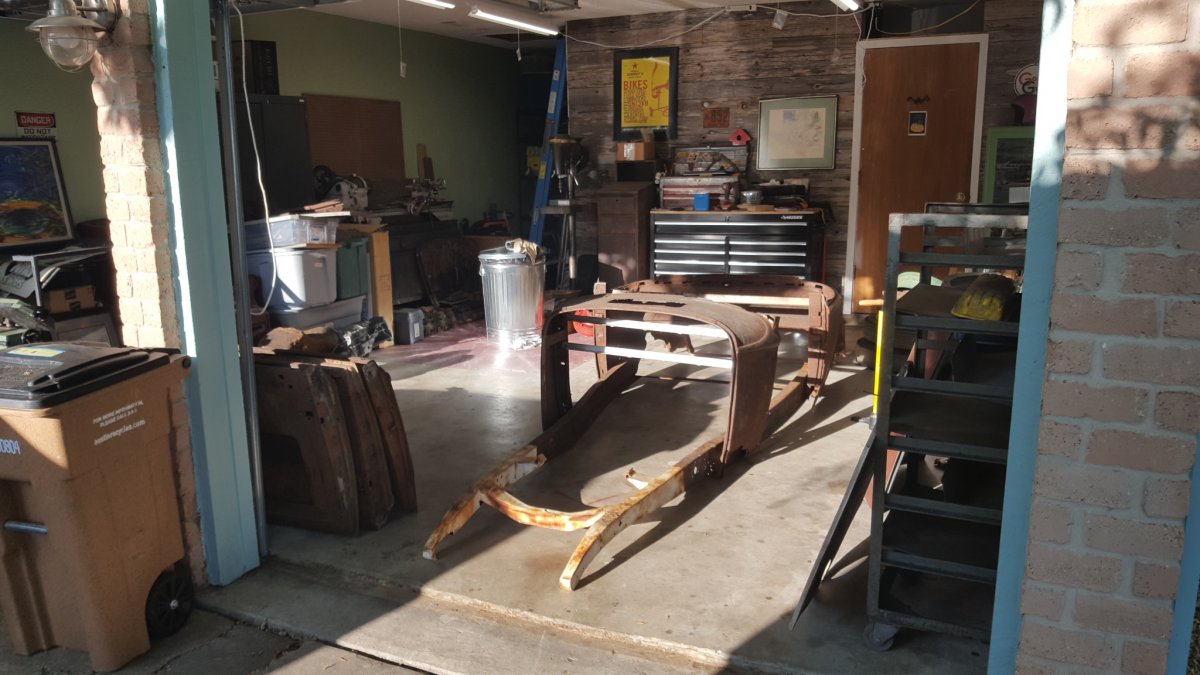

    Bumping this from the dead.
    After many life changes- marriage, selling the Cabriolet, moving to TX, buying a house, buying a '58 Chevy wagon, selling the wagon, buying the Cabriolet back; I am now finally starting to piece it back together in earnest. Work will be slow as I can only manage a few hours a week on it for now, but I will post what is going periodically.
    Following some wire brushing on the body panels, I have confirmed that the car was Blue, most likely washington blue. The wheel wells are definitly black, but I think that is only because it had fenders (raised in rear).

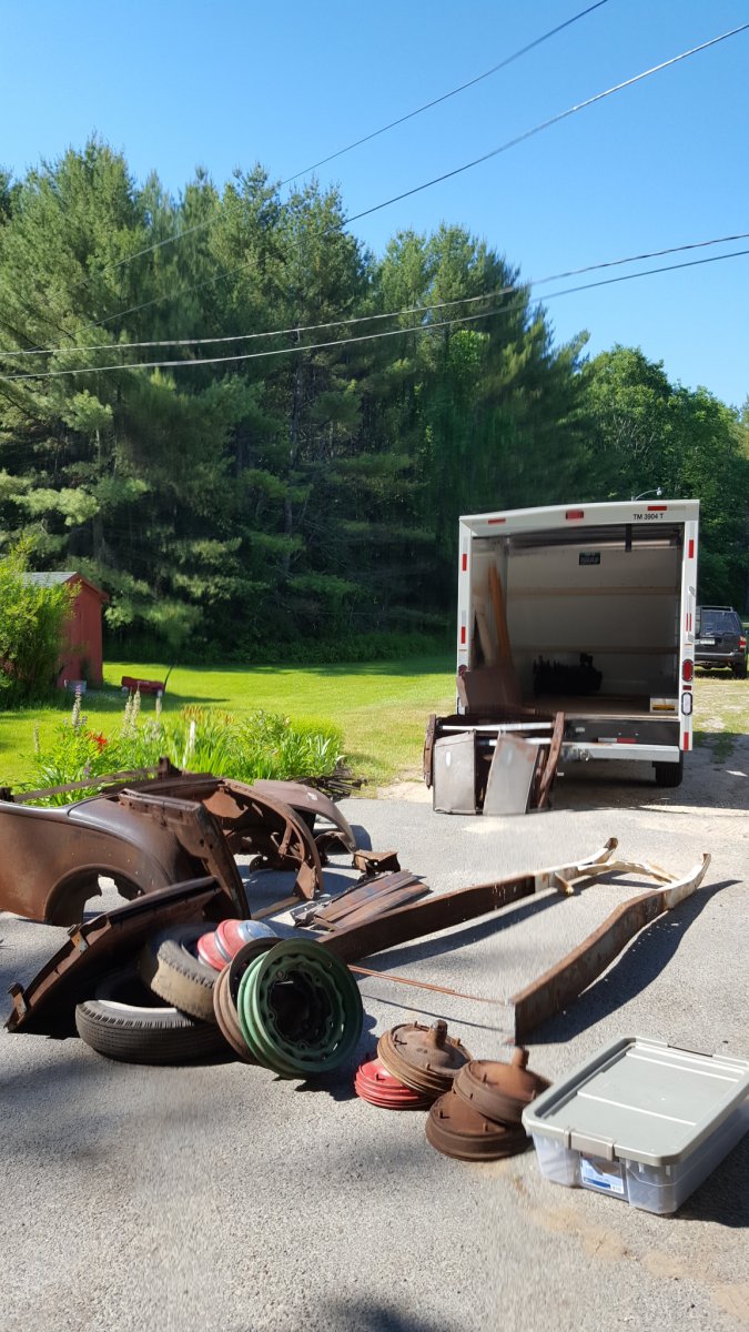

    Load up the pile in Maine

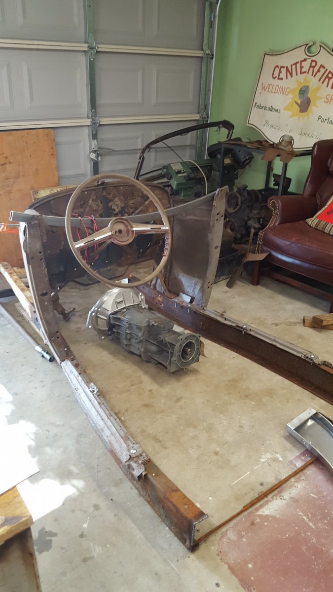

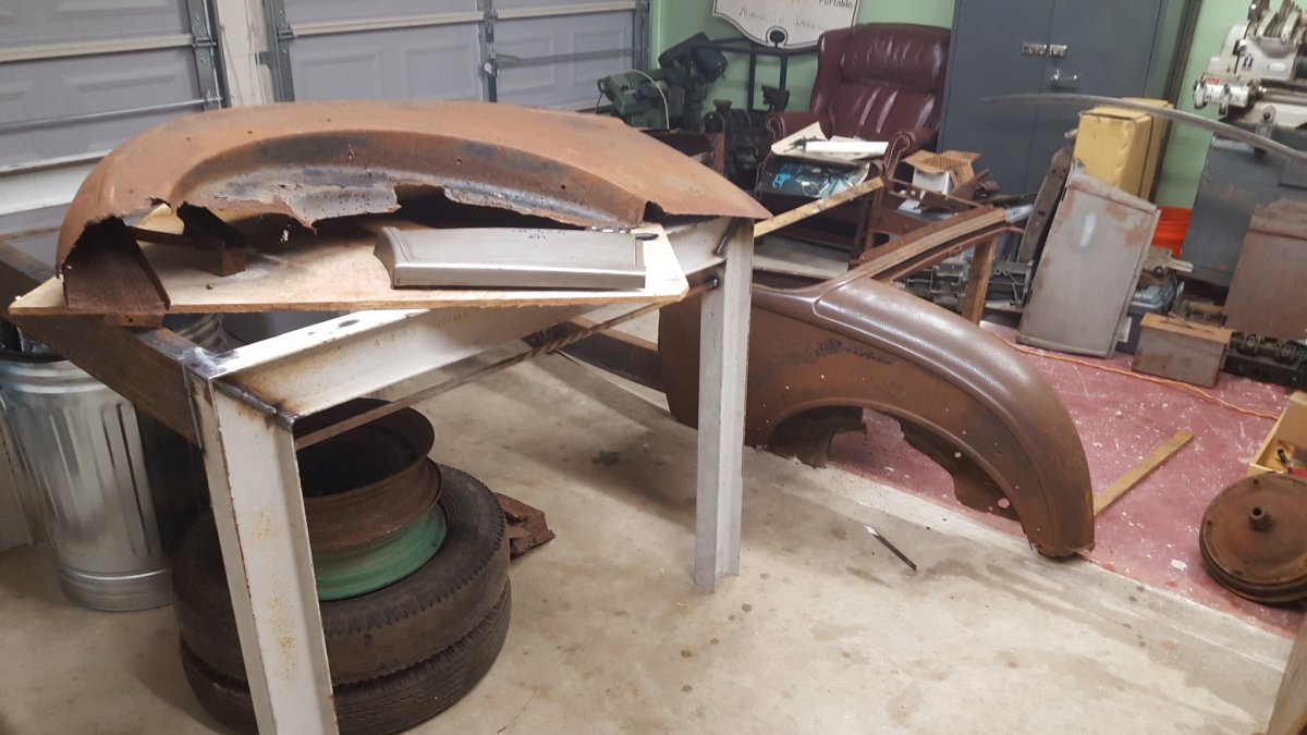

    Sometimes you have to go backwards to go forwards.
    Still not organized.
    I've been wanting to do that for years.
    To be able to do this.

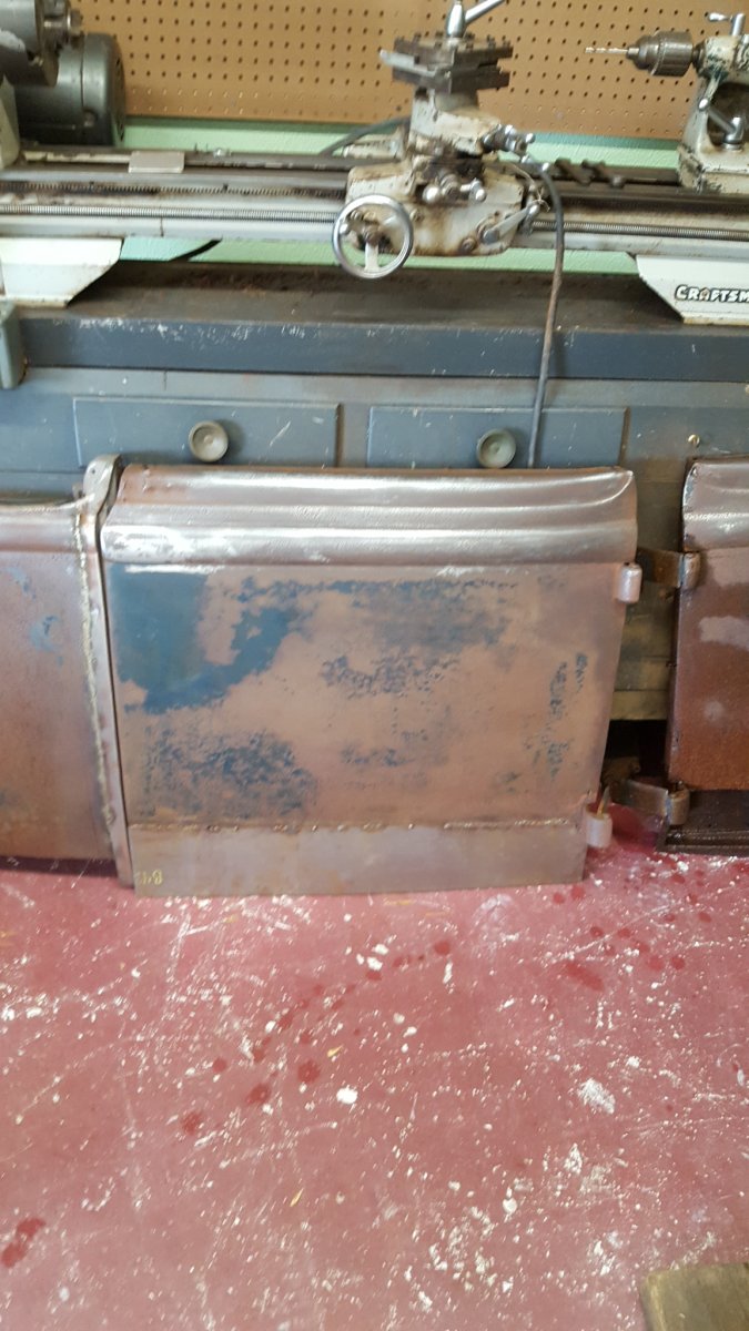

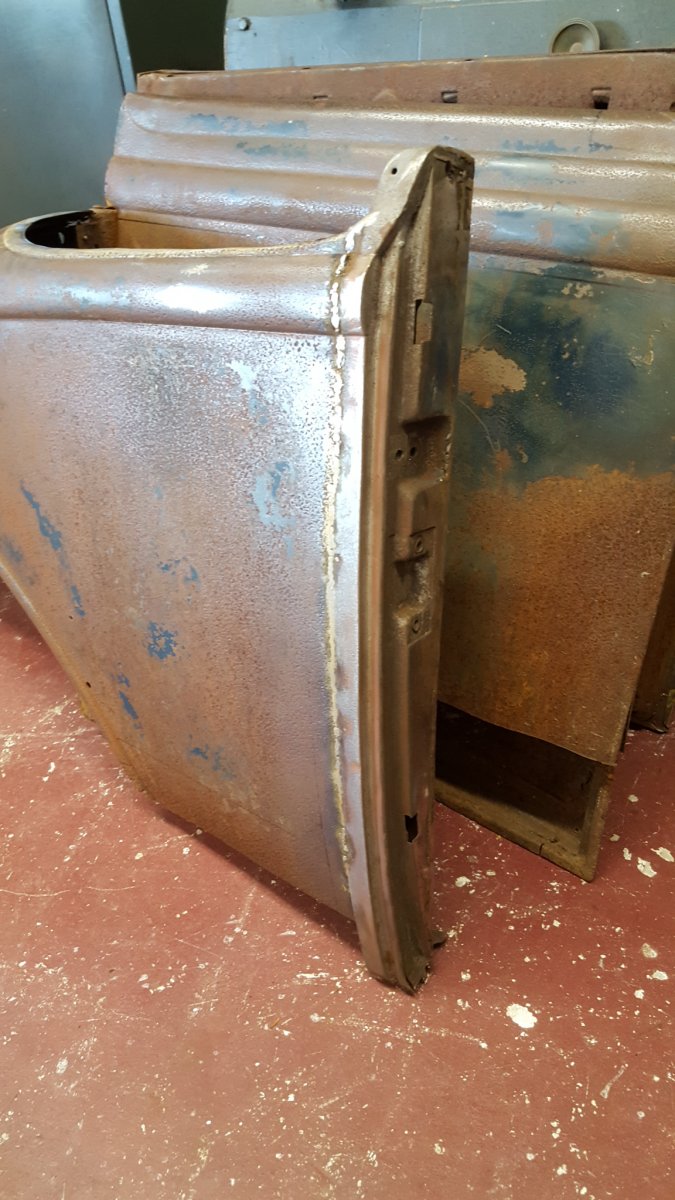

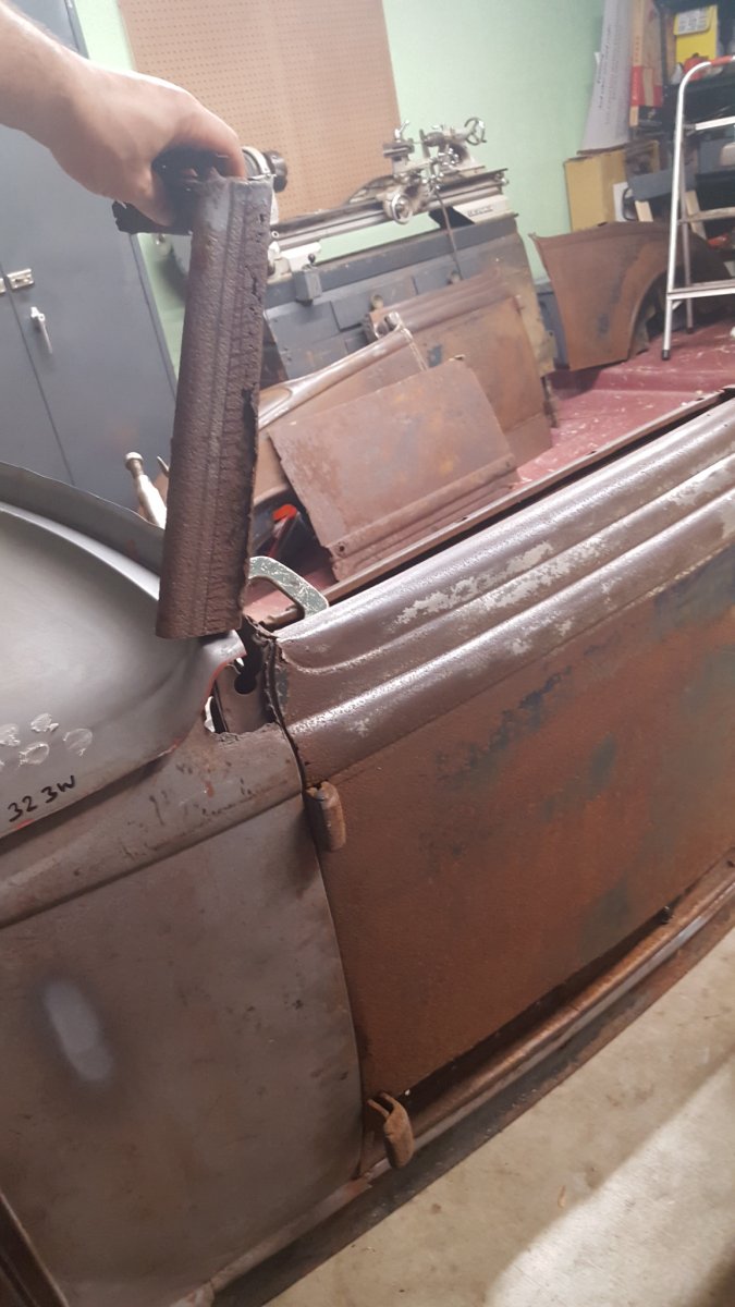

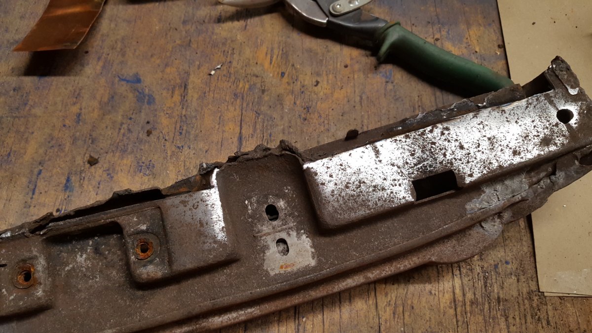

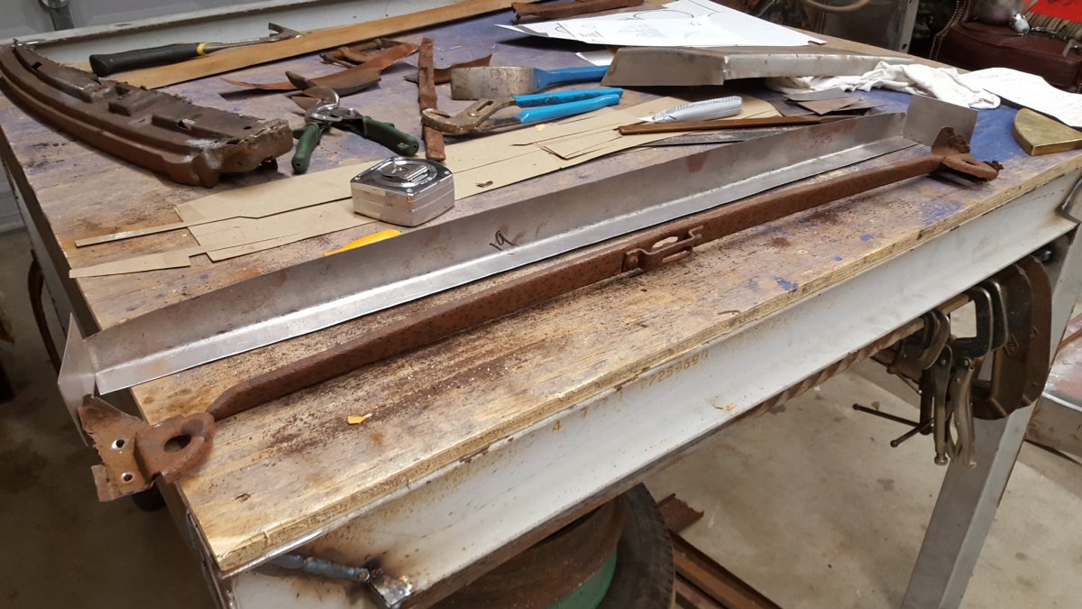

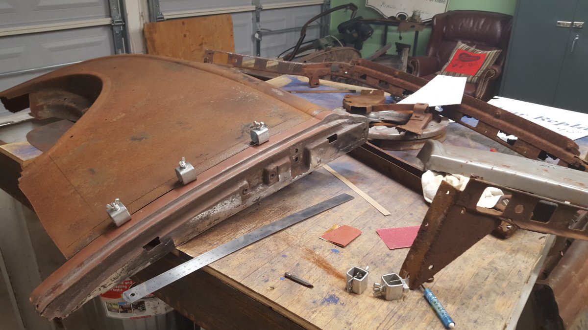

    Test fit of new Jambs. The original ones were split and wasted. Was fortunate to find these, as well as cabriolet rockers, and cowl sides with nice front jambs.
    Still needs some fine tuning with a hammer and dolly (and more grinding).

    Got a steering box at the Fredricksburg swap and had to mock it up.

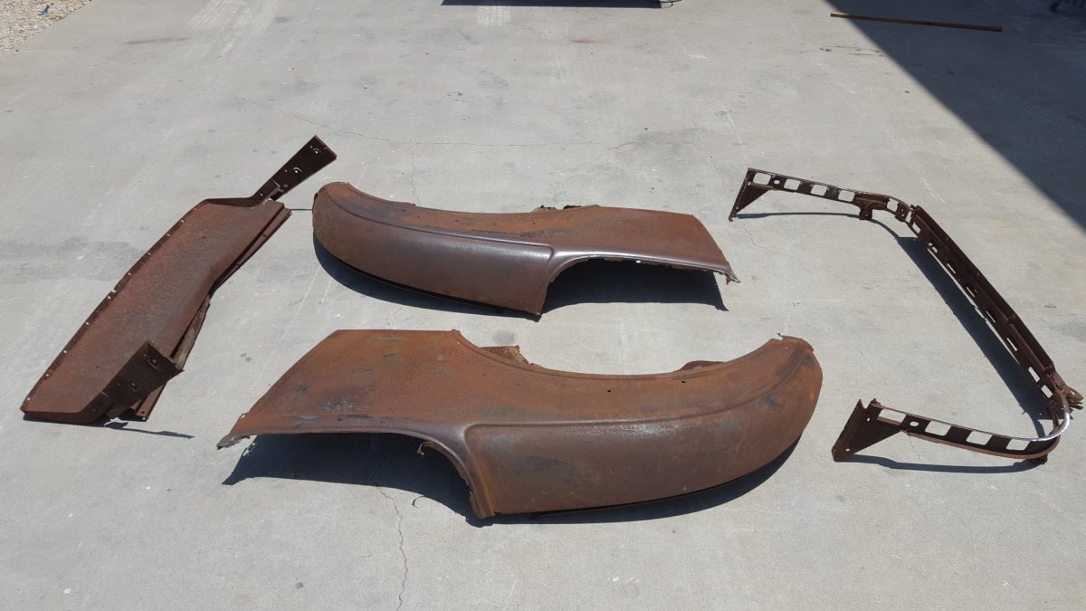

    I puttered around yesterday, stripping more rust, reasuring myself that there really is metal under it all. While sanding, I found the original color of the car, Brewster Green. I also started repairing the trunk rain gutter. Initially it looked surprisingly sound, but after pulling the quarters apart, pin holes surfaced and as I started cutting into it, it crumbled. I remade the rear part of the tough and will graft in the front half and the corner gussets as they are sound.
    I also pulled out the windshield posts from the original cowl. I think I will save them. All the really toasty parts are mostly flat simple bends.
    Yes, there is steel under all that oxide. And a surprising amount of paint.

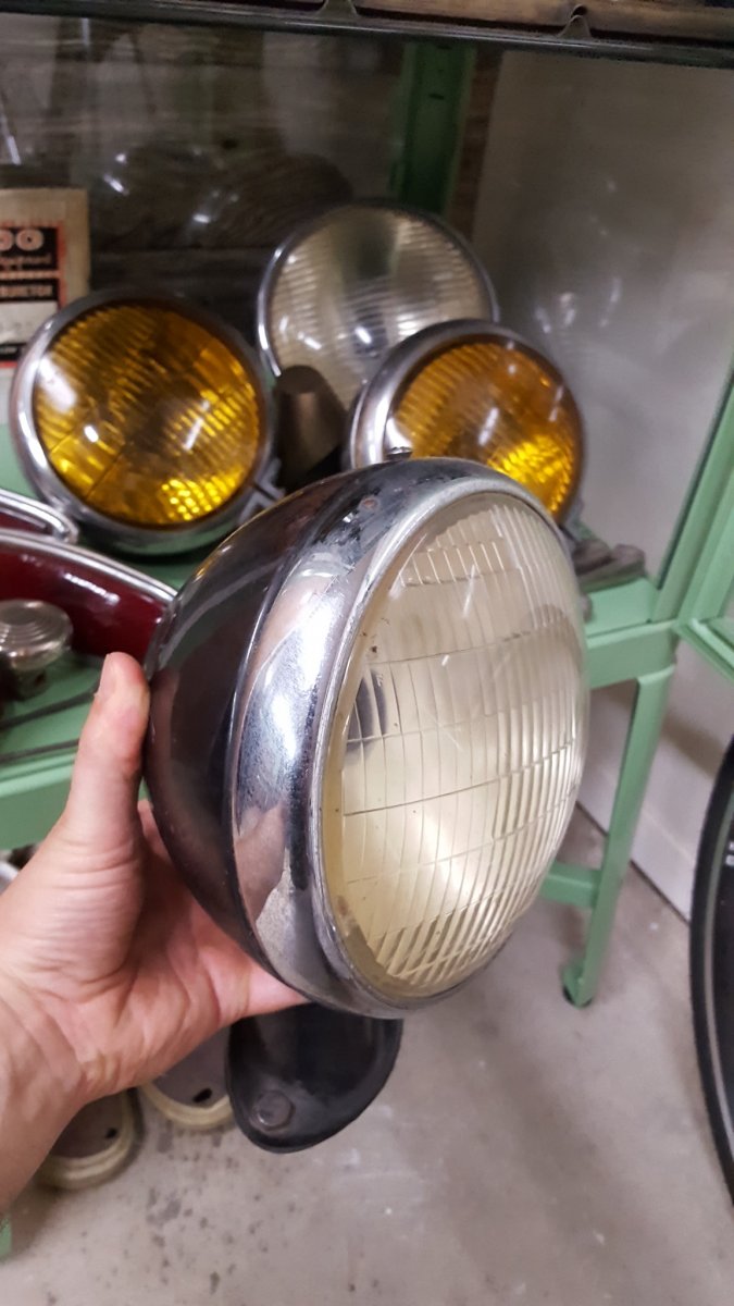

    Lucas 700 " King of the Road" headlamps.
