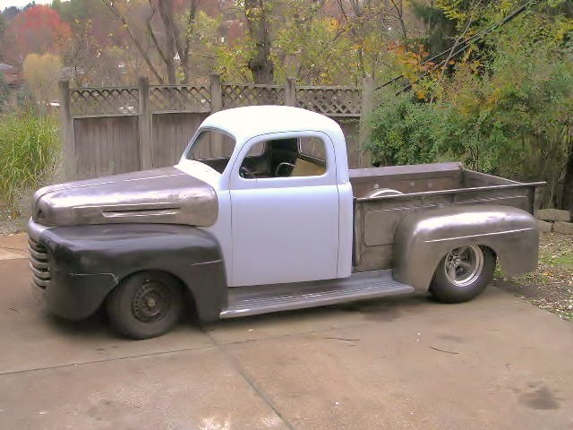

    I just came across this photo. Great job! I am building a 1952 F1. What motor and trans did you use? It looks like a perfect fit.

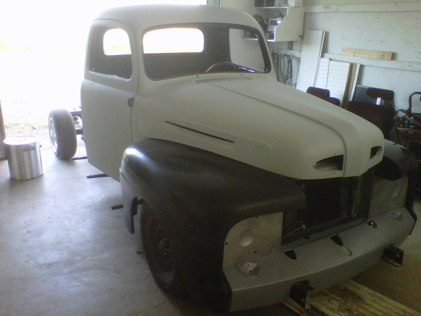

    Here's my 48 in progress. So far it has a 2" chop, sbf, tremec trans, and air suspension.

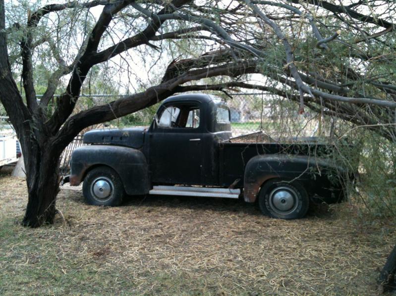

    Here is mine, just picked her up a week ago.

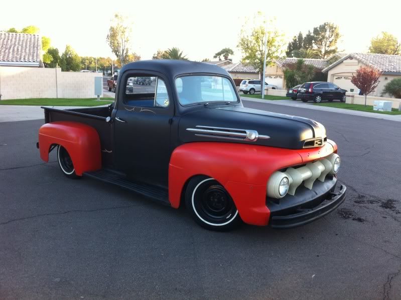

    Just had the truck painted! Used ppg bc/cc. Turned out really nice. Now for putting it all together.
    Going to run smoothies with a small center cap but cant decide on black with cap and beauty ring or red? Whats your thoughts?
