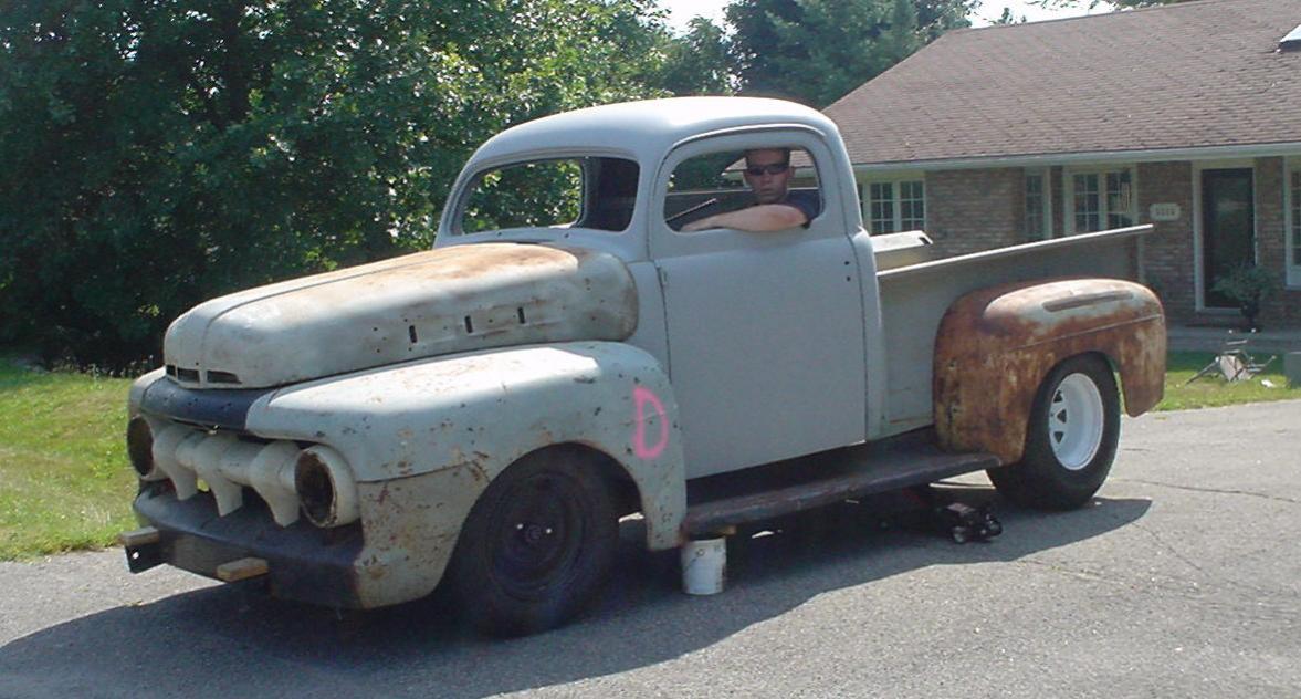

  7. Heres mine 50 F 1. Volare front end big step over the rear end mono leaf springs, cab is channeled to the running boards like the black one. When you do this its a channel from the doors back and a section in the cowl. Top is chopped 5 inches and the windshield is chopped only 4, notice most of the forehead is gone. I reskinned the roof with the crown off of a 40 Merc four door, it gives it more crown and I think it helps with proportions. One day I need to get off my ass and section the hood.

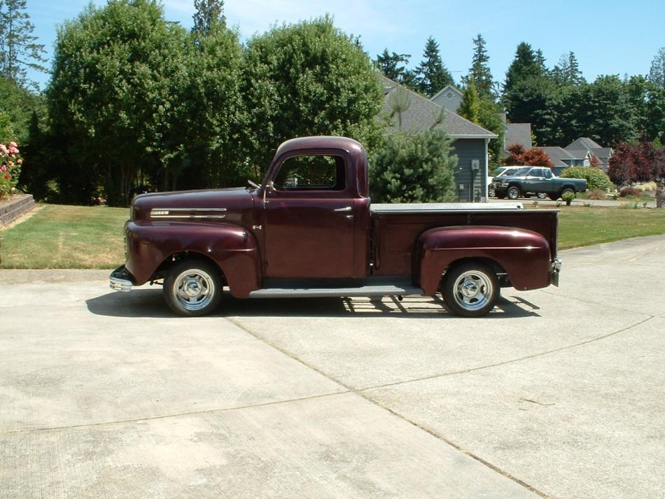

    Stock chassis with a Jag XJ6 front end bolted in. The rear is Cd with diff over the springs. No channelling done on mine.

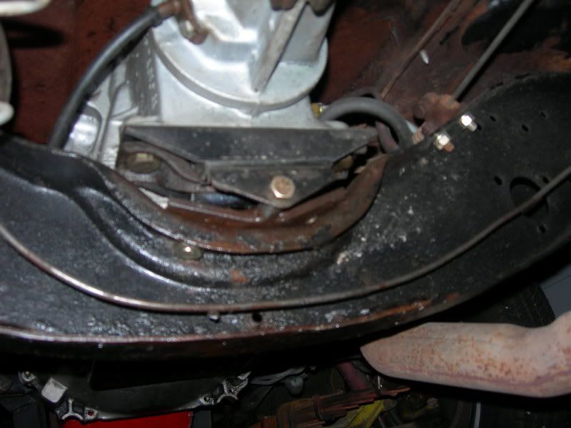

    When I first put my 52 f-1 on the road I put in a 302 and a c4 and used the stock brake system. I made motor mounts and positioned them so that the mounting pad of the c4 tranny was right on top of the mounting area for the stock tranny and made an adapter. The only downside to this setup is that I have to pull the tranny up though the stock tranny access hole in the floor when I change it.
    I now have a 393 and a c4 in the truck using the same 302 setup and still use the stock brake system except I converted it to a dual recivoir master cylinder and everything is holding up nicely for the last 15,000 miles or so.
    here are some old pics of the 302 and c4 installation.

    Why would you have to pull the tranny up through the access hole? Is it tight on clearance between the crossmember and the underside of the cab? How did you put the trans in? Sorry for all the questions.
  21. fordf1trucknut
    Joined: Feb 13, 2007
    Posts: 1,179
    fordf1trucknut
    When I changed the tranny (due to blowing it up with the 393) I pulled it up though the cab floor since the tranny crossmember is rivited in place and would have been a lot of work to make the crossmember removeable since it has a bunch of rivits that would need drilled out and replaced with bolts in addition to the work to remove the pedals, master cylinder and brake lines......
    Then I put it in the truck I installed it with the motor with the front clip off. When I changed the tranny i didn't want to have to pull the front clip and the motor so I just used the stock access hole for the manual tranny.
    As far as clearance it has a tiny bit but not much.. If a fat person rides with me somewhere I can hear the floor tap the tranny on bad bumps but if my wife or pretty much anyone else rides with me there are no issues....(I am 6'8" tall and weight 250 lbs... if somone else 225+ rides that is the only time it rubs on bumps).
    I managed to swap in my entire drivetrian with only having to drill 8 extra holes in the frame for my motormounts. No modifications anywhere else, I could swap the flathead back in in a saturday.
    I used a case fill c4 with a bellhousing off a 1980 contry squire station wagon (it is the larger bellhousing that takes the bigger flexplate). For the rear axle I used a 9 3/8 rear out of a 1970 f-100 4x4 (all 9 3/8" rear axles are 31 spline) and it was a bolt in swap.

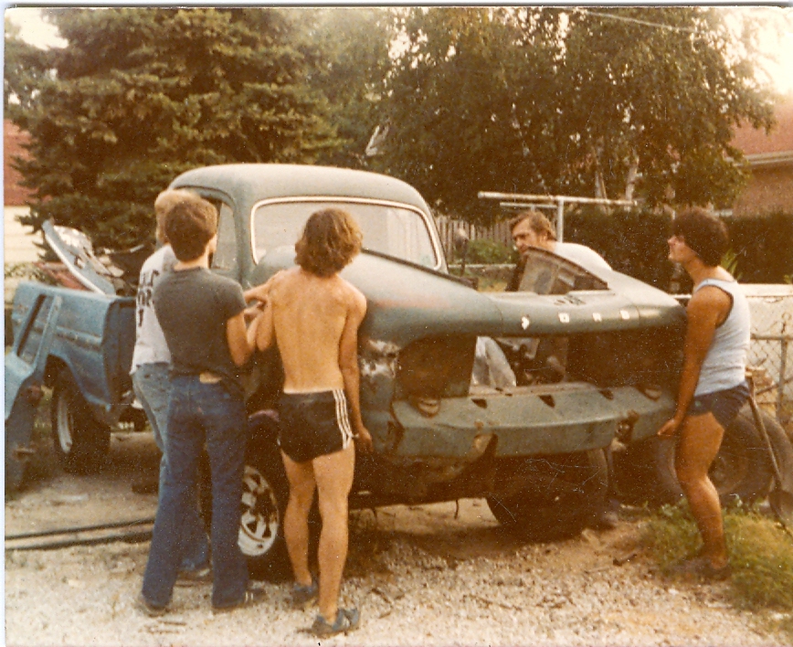

    here is my 52 that i biult on a 68 f-100 frame with a 390 3spd. did this in the 80's

    I looked at how you channelled your cab raising the floor & firewall and trimming just the top of the firewall, no seam to hide- good solution!
  26. and the scar in the side of the cowl is under the fender. No one ever saw the channel but it was low as shit

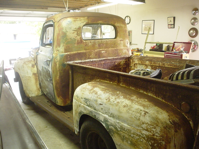

  27. I picked this one up through a trade with Chadillac here on the HAMB. It has a lot of small parts that will go on my '50. It's actually a lot better than it looks.
