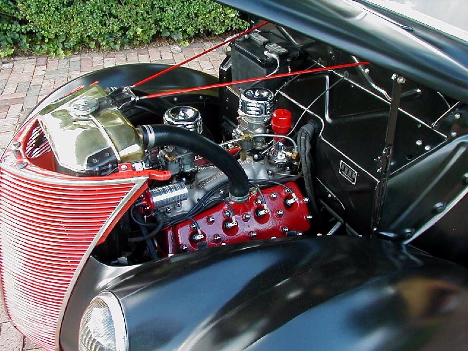

    My club brother Tudor bought an A/V8 tub a couple weeks ago, and while it's basically a solid car, there are a few bugs, including a very sluggish engine.
    59A flathead, only visible modification is Thickstun intake with 94 carbs, one of which is blocked off with a plate between carb and manifold. Manifold has cast in number "PM7".
    There is a bit of doubt about whether this manufold is a conventional 180 degree with only small balance passages between front and rear carbs, or a 360 degree common chamber feeding all 8 cylinders. I'm thinking it's a 180* and another old fart like me is thinking 360*o_O
    Obviously if it's 360* it will run OK on 1 carb, just not breathe as well as it would with 2. But if it's a 180* and you're trying to run it with one carb blocked off, there's gonna be 4 cylinders only getting what air/fuel mixture that can get thru the balance passages, which ain't much:confused:
    I haven't been inside a flathead in about 50 years, and the only Thickstun manifolds I ever saw were in magazine pics, and I don't recall seeing a pic of the Thickstun's underside, which would reveal whether it's 360* or 180*. Anybody out there that knows from personal experience whether it's 360* or 180*, please respond.

    These are great intakes. Adds Horsepower.
    You shouldn't have any issue running both carbs.
    I'd definitely unblock the other inlet.
    You are starving four cylinders.

    Petejoe, it appears you are showing 2 different manifolds, the first obviously a 180*, and although the second is different and sorta flat on the bottom, it also appears to be 180*.
    But are both PM7?

    These were taken from google. I'd bet money the differences are between the old ones and the repops.
