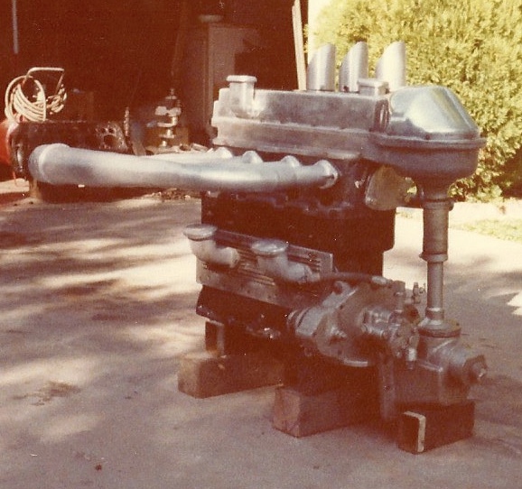

    Your overhead cam attachment is Lindsay, your head is a McDowell. fullsizeoutput_a07.jpeg DSC04891.JPG Most 2 port McDowells have dual ignition, does yours ? Here's some photos of my shaft and bevel gear drive Nichols, also on a McDowell head.

    Thank you! Mine is a bit different, drive-wise. Vertical shaft drives off the cam gear on mine, not the crank. Also, no 3-bolt hole in the front of my head... do you still think it is a McDowell?

    Yes, appears that it is dual ignition, although the exhaust side has been plugged for now.
    Your cam drive is interesting... I wonder if there is any theoretical advantage to driving the cam off the crank (as yours does) versus off the original cam gear (as mine does). Mine also drives an oil pump off the front of the crank, so my in-block cam is only there for the OHC drive (!) and the magneto drive.
    I also notice that yours has the water crossover pipe intact (mine is missing). On your engine, does that pipe replace the stock water outlet on the left side of the block, or is it in addition? My guess is the former, but I have a lot to learn.

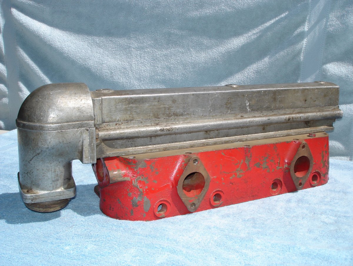

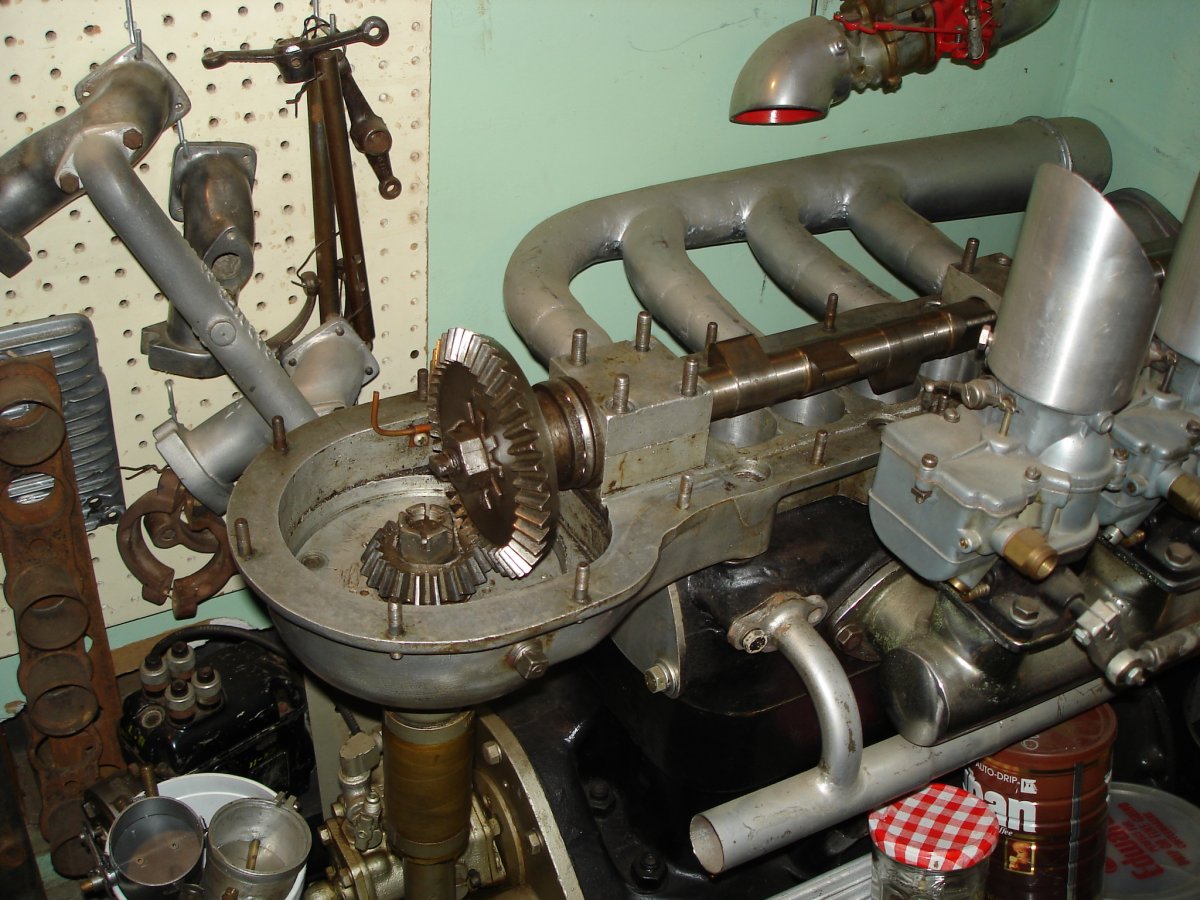

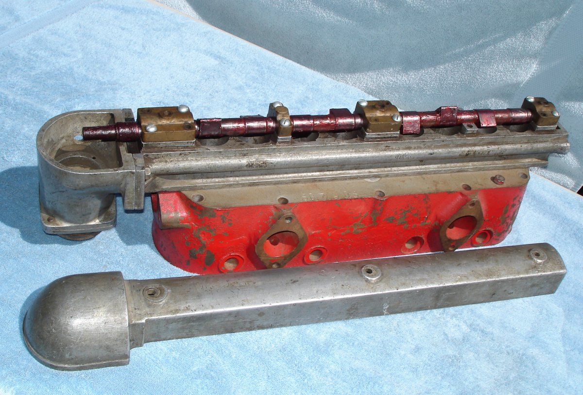

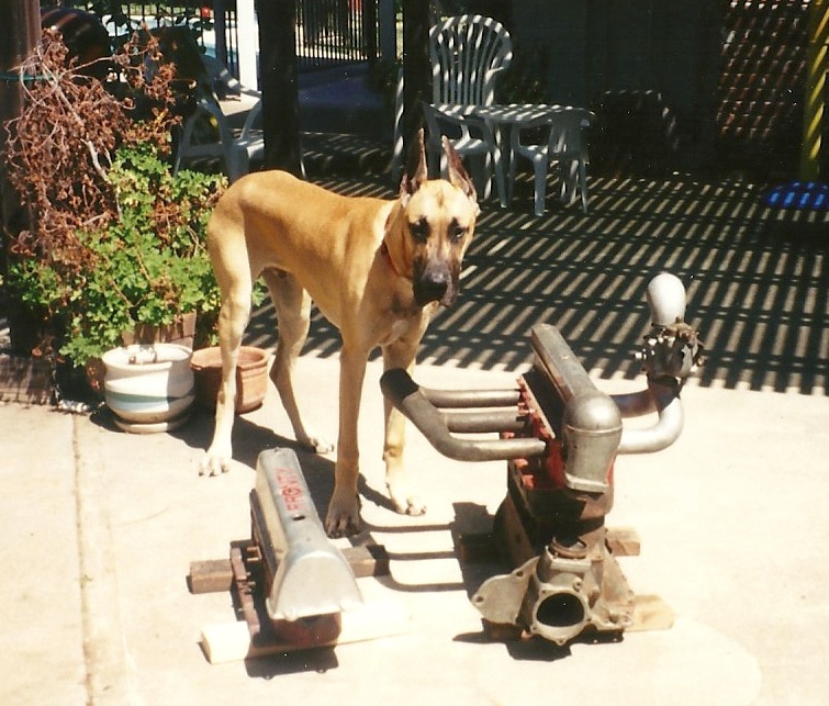

    Your gears and drive are based on and use parts from a 1920's Wills St. Claire V8. I have a Model T shaft and bevel gear drive OHC that uses Wills St. Claire parts and is similar to yours. The head is an SR Fronty and the cam drive is McDowell. I've had this setup 33 years and have never seen another. McDowell 006.jpg McDowell 004.jpg fullsizeoutput_a05.jpeg fullsizeoutput_26e.jpeg fullsizeoutput_2cc.jpeg DSC08270.JPG

    I've decided to sell this engine... PM me if serious. I've found out from a couple of reliable sources that the castings are all McDowell. Exceedingly rare, apparently.
