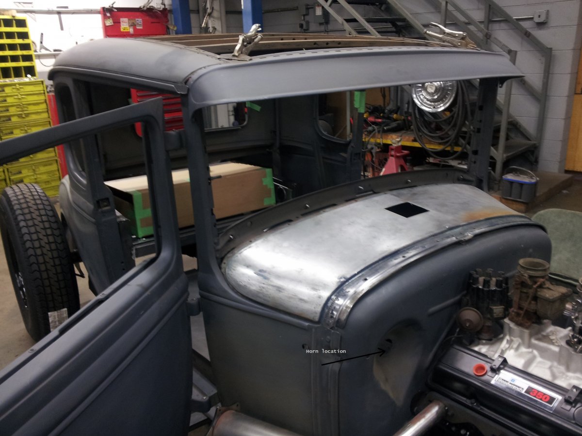

    Building a 31 Model A hot rod and I've been told guys use vintage Indian chief motorcycle horns mounted in the fire wall . Any pictures or info on this, also the vintage stuff was 6 volt any conversion to 12v to make in functional? Thanks for the help

    Unless you are stuck on the Indian horn, why don't you run a Bosch pancake horn that's 12 volts?
  3. The horn will work 12V it doesn't care. You will have to use a 12v horn relay though.
    Guys don't use Vintage Indian horns they used them when they were not vintage. you won't see many of them in use these days Indian parts rank right up there with deuces. :(

    Find an old pancake Klaxon horn at a swap meet, not some $$$ Indian. Usually about 10-15 bucks. And the 6 volt horn will really wake up on 12 volts.

    That's a really neat looking horn.

    No, that's a neat looking engine compartment in general.
