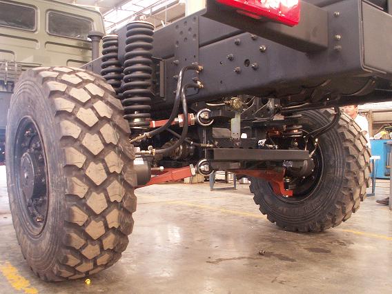

    There's nothing wrong with IRS in a truck. You can get better handling with the lower unsprung weight, But you don't have to compromise towing capacity, either. You just have to engineer it to do what you want.
      86.6 KB
      214
