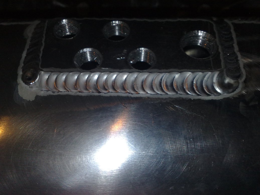

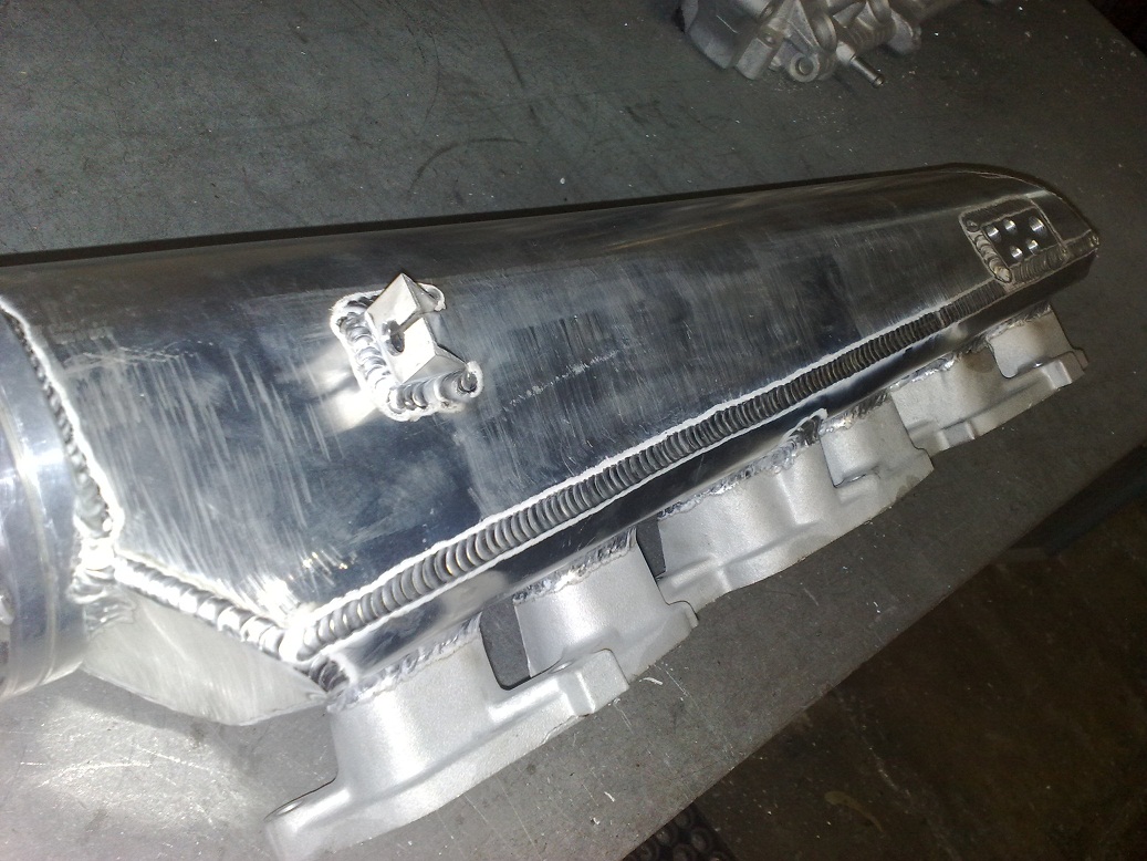

    Hi Guys....my first post here after being linked to Bass killer build thread. Here is some of the work I do from Down Under.
    By no means do I believe I am up to the standard of some on here, but like others, striving to improve puts it lightly.
    For some reason welding cast steel or aluminium just turns out really well for me....well I think so anyway, not sure what it is.
    The last two have to some of my favourites!!
    Cheers,
    Ariel

    some really inspiring stuff here!
  5. TurboX2
    Joined: Oct 1, 2012
    Posts: 207
    TurboX2
    Awesome welds!
    I was always told a grinder and paint makes a welder what he aint!

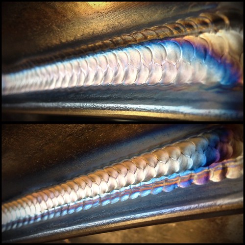

    The following is: First pass lay wire walking the cup, 2nd pass dipping rod walking the cup consistent amps, 3rd pass(bottom 2 pics) freehand, dipping filler, slight pedal pulse.
    <a href="http://www.flickr.com/photos/browndogwelding/8511980704/" title="First pass lay wire walking the cup, 2nd pass dipping rod walking the cup consistent amps, 3rd pass(bottom 2 pics) freehand, dipping filler, slight pedal pulse. #weldporn by Brown Dog Welding, on Flickr">[​IMG]</a>
    The 3rd pass again, slightly better pic
    <a href="http://www.flickr.com/photos/browndogwelding/8529259627/" title="Too lazy to walk. #freehand #weldorhumor #Imhereallweek by Brown Dog Welding, on Flickr">[​IMG]</a>

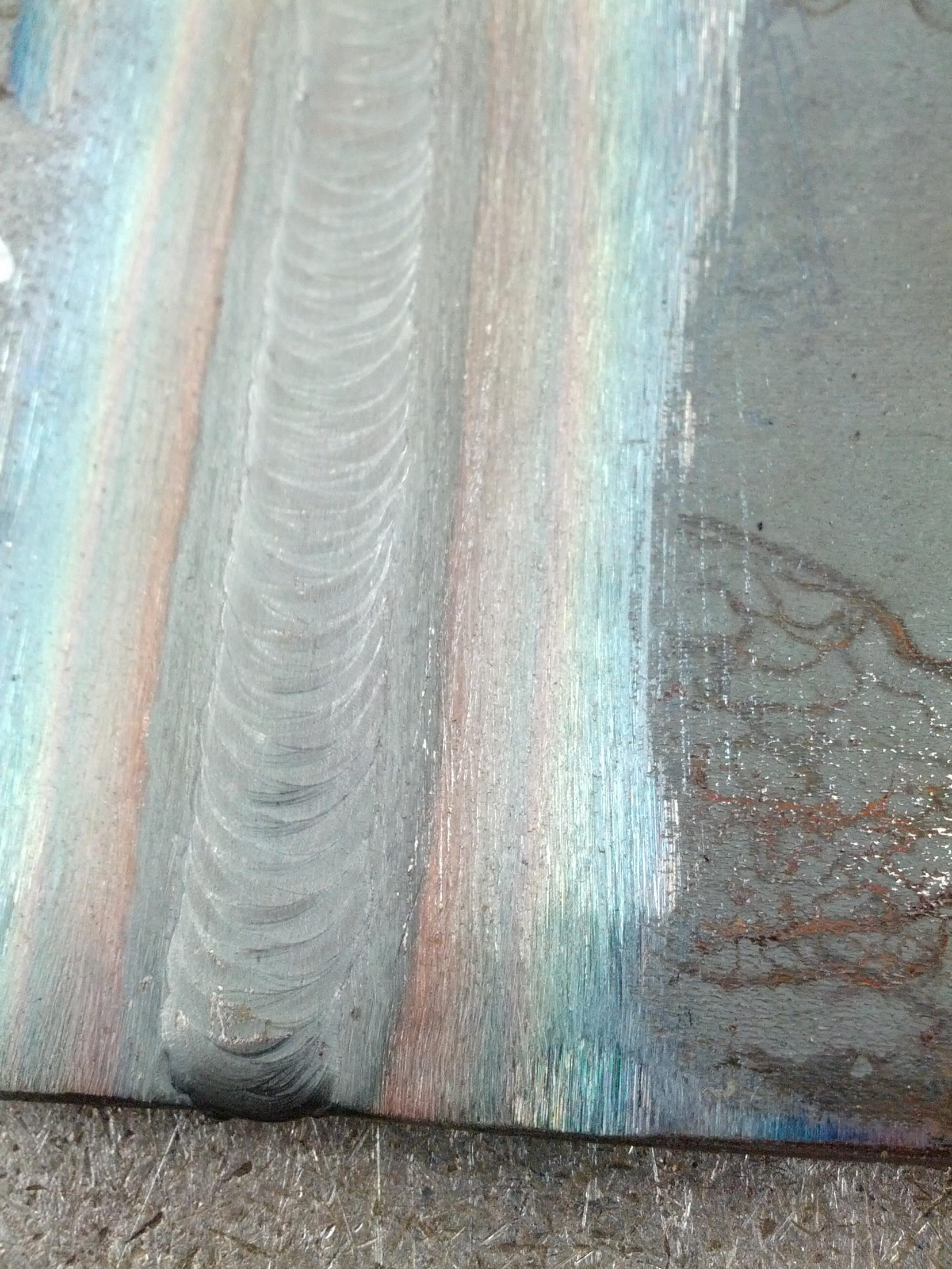

    A verticle 3G groove weld, open root full penetration Tig weld on 1/4" plate.
    One of the projects we demo to our apprentices.
    This is the cap side, as welded, not brushed to make it shine.

    very nice weld..... do you have a pic of the back side you could share ?
    and was that a single pass ?
    thanks
  18. Blue One
    Joined: Feb 6, 2010
    Posts: 11,459
    Blue One
    from Alberta
    I can get a pic of the root pass, don't have one handy.
    It is a 3 pass weld, root, fill and cap.

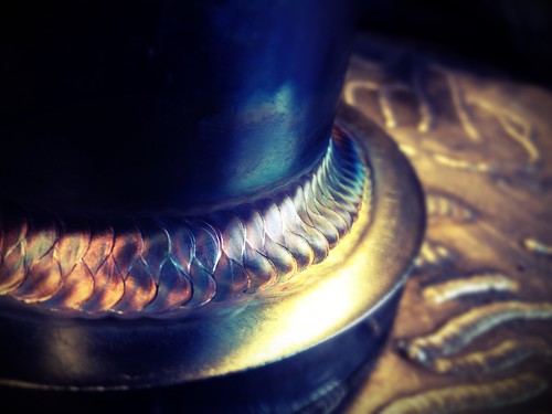

    some more stuff...none of this was "walking the cup"
    <a href="http://www.flickr.com/photos/browndogwelding/8605942619/" title="Sunday Sermon. Free hand. #preachmetal #nowalking by Brown Dog Welding, on Flickr">[​IMG]</a>
    <a href="http://www.flickr.com/photos/browndogwelding/8610940043/" title="&quot;Mastering others is strength. Mastering yourself is true power.&quot; Today was rough. Dynasty 700 therapy session. by Brown Dog Welding, on Flickr">[​IMG]</a>
    <a href="http://www.flickr.com/photos/browndogwelding/8609922576/" title="&quot;The artist is nothing without the gift, but the gift is nothing without work.&quot; #welding #notwalkingthecup #metalmonday by Brown Dog Welding, on Flickr">[​IMG]</a>
    <a href="http://www.flickr.com/photos/browndogwelding/8614380573/" title="One more for #tigtuesday by Brown Dog Welding, on Flickr">[​IMG]</a>
    This one was walking the cup:
    <a href="http://www.flickr.com/photos/browndogwelding/8583364843/" title="Frustrated with a sculpture. So I keep going around this pipe. #welding by Brown Dog Welding, on Flickr">[​IMG]</a>

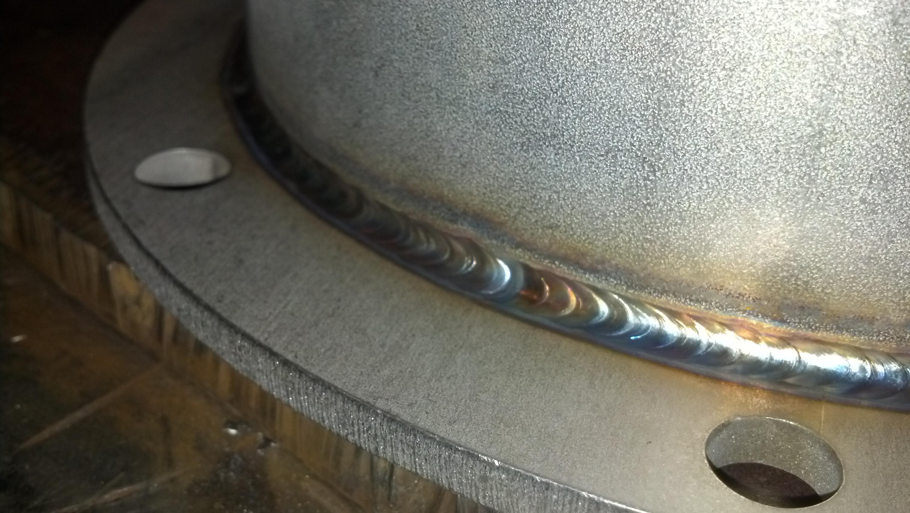

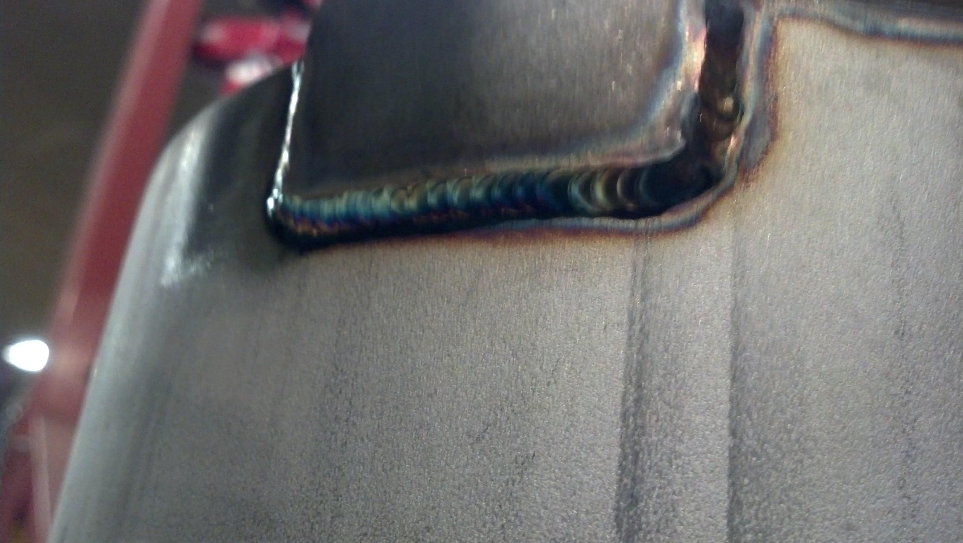

  26. More of my crap. All free hand 308 stainless.
