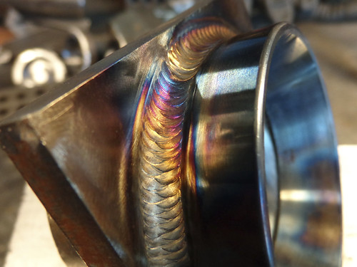

    Here's more free hand practice.

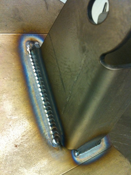

    Figured I'd work on my off hand, this one was lefty:
    <a href="http://www.flickr.com/photos/browndogwelding/8315259156/" title="&quot;But can you do it with your left hand?&quot; #goingbackwards #leftyforaday by Brown Dog Welding, on Flickr">[​IMG]</a>
    plain old righty
    <a href="http://www.flickr.com/photos/browndogwelding/8311701042/" title="Weld away the winter blues.... by Brown Dog Welding, on Flickr">[​IMG]</a>

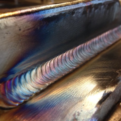

    This one was free hand:
    <a href="http://www.flickr.com/photos/browndogwelding/8350422127/" title="Some #weldporn for the weekend. Freehand. Just trying to stay warm! by Brown Dog Welding, on Flickr">[​IMG]</a>

    Walking the cup is a welding technique often used when weaving a larger pass on pipe or fillets. The cup rests on the work. I did that free hand, without letting the cup test the work. Different situations call for different techniques.

    So at the risk of sounding stupid, you use a cup to rest your hand on to keep the proper distance from your work, right? I'm a novice welder with a mig, I've never tiged.

    The cup is part of the TIG torch. It's porcelain, so you can rest an edge on the work.

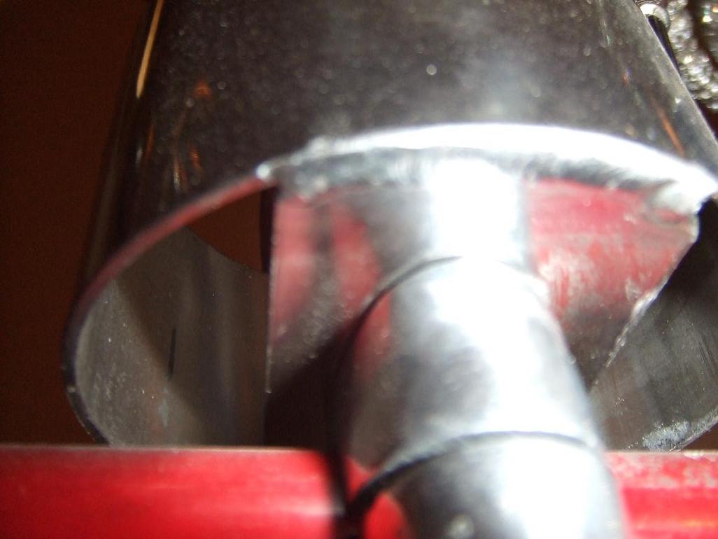

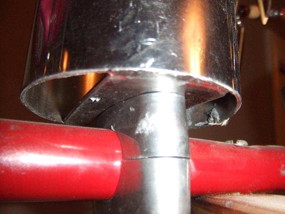

    Incredible for all the wrong reasons.[​IMG][​IMG][​IMG][​IMG][​IMG]

    Spent several hours practicing my TIG welding this afternoon on 18g. Simple butt welds.
    After seeing these welds I think I'm going to put my unit to good use tomorrow. I'm going to weld the door to my garage shut.
    You guys are making me sick to my stomach !!
