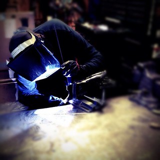

    OK, I know you've explained this before, but I still can't get my head around how you do that! I mean, I can tig, but that, that's just unbelievable! Could I beg you, once more, to go over in detail how to do it, in detail?

    I just typed a bunch of jibberesh out, and then remembered I explained it all much better in this post:
    http://watchtheprettylight.tumblr.c...yle-and-profile-walking-the-cup-bob-and-weave

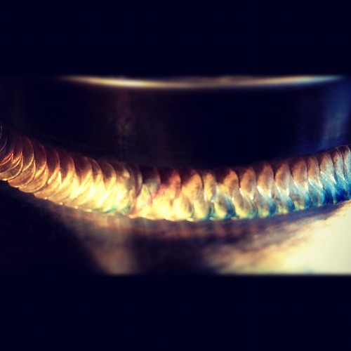

    I'm gonna go celebrate Labor Day the best way I know how...with labor. Some recent stuff:
    1st pass:
    2nd pass:

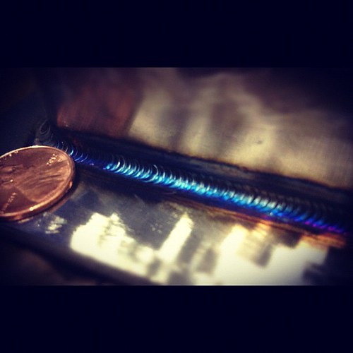

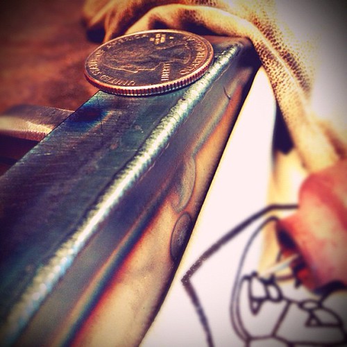

    A small fillet:
    Messing around with freehand weave. 3 pieces of metal.
    First pass on a fillet:
    2nd pass on a fillet:

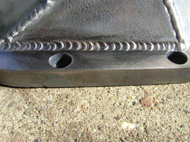

    What the hell is wrong with me?
    This is about as good as it gets …. Except my alum stuff is a bit more consistent looking

    Just throwing this out there, take it for what it's worth. See how the vertical steel piece is pitted on the surface? It's not necessarily dirty or contaminated, but it's rough. The cleaner/smoother you have the steel, the easier it is to lay down a consistent and smooth bead.

    It looks to me that you're moving the puddle before it's finished forming... You may have a bit too much heat in it still as you're starting to move to the next puddle. Also, that's some pretty hefty material - what amps are you putting in to it?
    X2 on the material looking a bit pitted.

    Slow down a bit and let it burn in a bit.

    Not L handed
    I probably had it tipped up the other way
    I think I had it on 165 amps
    That is a dana 60 cover
    The ring is 5/8 so the socket heads will be flush and the rest is 3/16 …. Heavy duty yes for sliding on rocks.
    The steel was all supper clean ... blasted and ss wire cup brushed.
