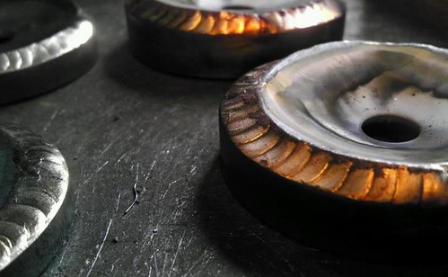

    Did a couple belt buckles today, all stainless...

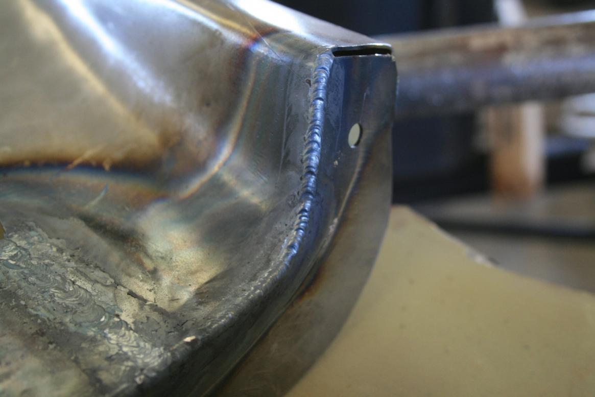

    I did a hot rod sedan sculpture today. These are the wheels, front and back. Silicon Bronze. It's nice 'cuz it looks cool, there's some color contrast....plus it melts before the base metal, so it fills in empty space instead of eating away the edges.
    silicon bronze tig braze by Brown Dog Welding, on Flickr
