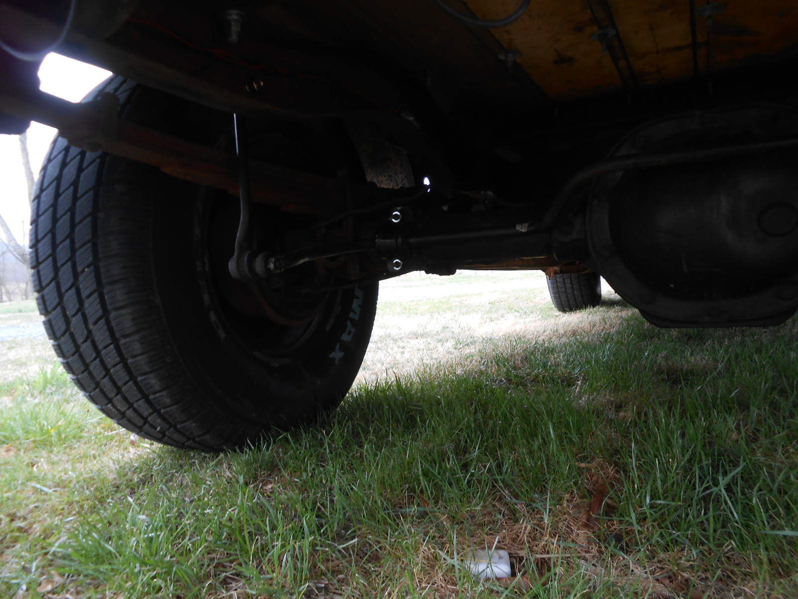

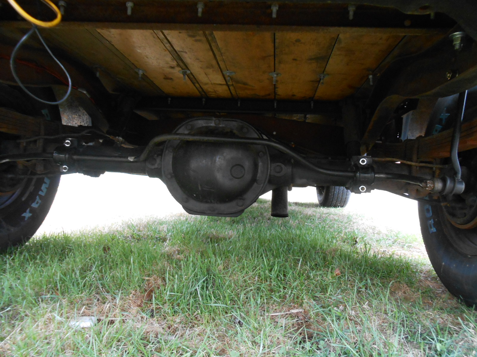

  1. I wanted to improve on the handling to my f1 but keep the original type of spring setup. I asked around if anyone had installed a sway bar to this type suspension with none having responded with real world tech SO.
    I began searching for parts that came close to what I thought would work and with some slight mods I installed one to my f1 ...
    I also added radial tires and t5/overdrive 265/75/15 coopers on the rear and 225/75/15 coopers to the front
    installed posey front springs lowering the front 2.5 inch's
    I removed every other leaf from the rear springs and reversed the rear hanger to lower the rear giving the truck a 1/2 inch rake and lowering the center of gravity a few inch's
    I added traction bars to the lower side of the rear springs to stop wheel hop and clutch chatter in low or reverse
    NOW for the results.... I can't begin to tell you how much these changes improved the handling and overall safety of my f1.. It once was a farm truck made to run down old country roads to now capable of todays interstate highways ...No longed just a parade truck ..I can run 75+ MPH
    at around 2450 RPM
    hear are some photos of the changes

  8. charleyw, the rear bar came off a 2007 Tahoe front end.. I heated it and bent it around to around 90 deg.on each end to fit the rear of my f. I purchased a mustang connector link to connect to a fabricated bracket I installed between the spring and rear end housing I used 2x4 steel box tubing for the frame to bushing mount ..
    by the way the bar looks to be too big but it is 1 1/8th dia hollow high grade steel with 1/8th inch thick wall very light in weight but very effective

    for the front I found one on e/bay from an 88 Rolls Royce Silver Spur rear bar.. I had to heat it in the bends to widen it to fit. Just cool it quick to keep it hard. I looked on e/bay under used sway bars and found both the ones I put on my f1. there are hundreds to choose from and most are cheep. measure and ask for size and width from the seller before you buy .I had to heat and bend both of mine to fit. the rear bar was 2006 ford mustang 1.250 hollow bar ,it had to be bent inward on each end to work on my f1.
    pm me if I can help.. John
