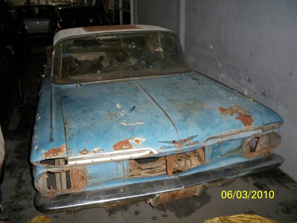

  1. Hi! I´ve recently bought a 1959 4 door Impala, and I was wondering if it could be converted to a 2 door ride. Anybody with pics and measures??
    Thanks! Sergio

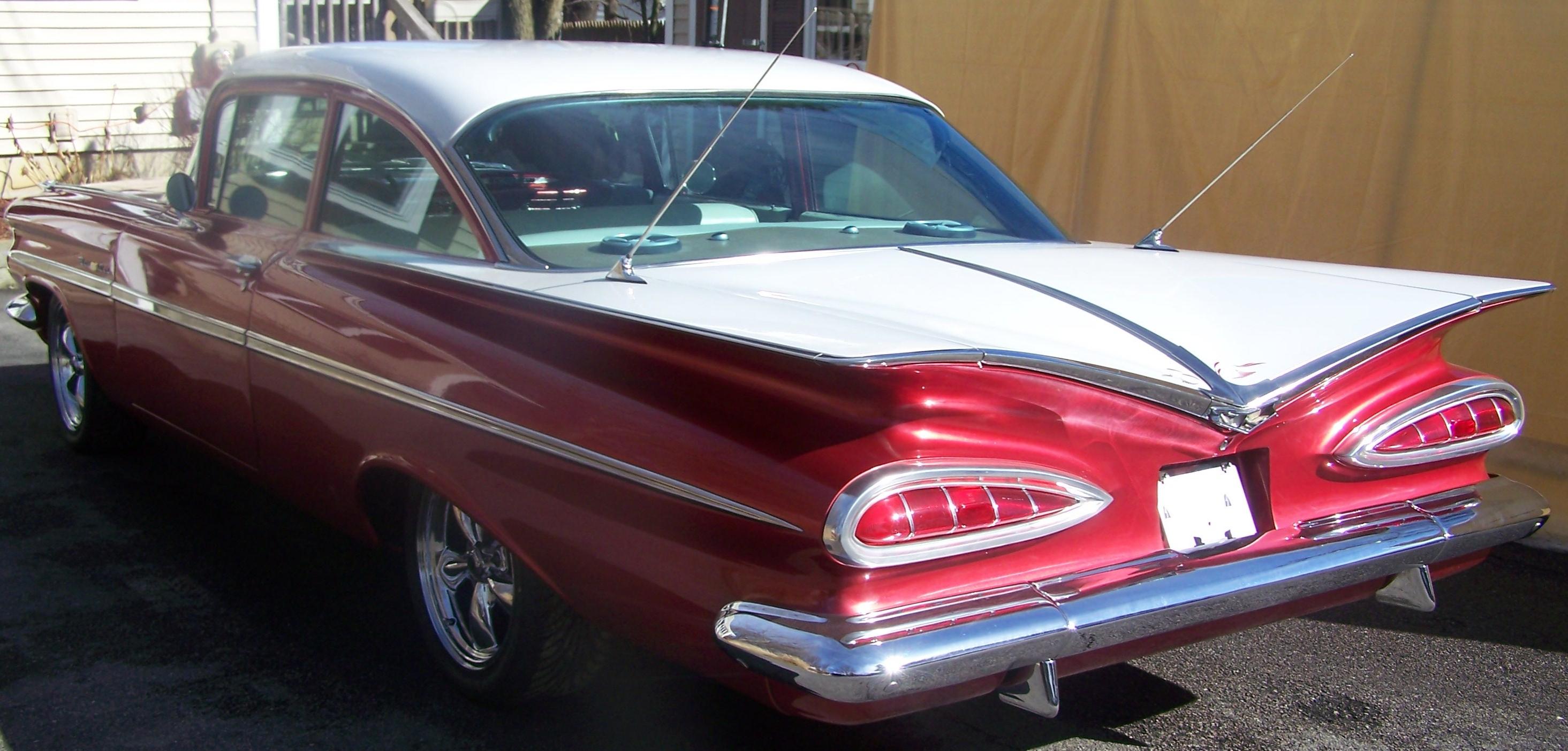

  7. jobba7234
    Joined: Feb 5, 2009

  8. jobba7234
    Joined: Feb 5, 2009
    Posts: 9
    jobba7234
    from RI
    a couple pictures..

  9. trukin55
    Joined: Jan 27, 2008
    Posts: 139
    trukin55
    OMG! Jobba, You are awesome. VERY impressive. That car looks great. You must have alot of patience. I am curious, how long did it take?

    I was just about to hunt down the link to this build but I see the builder has posted it already. Very impressive work if I do say so. I'd say the question of "can it be done" is pretty clearly answered "yes" with that one.

  16. jobba7234
    Joined: Feb 5, 2009
    Posts: 9
    jobba7234
    from RI
    Hi Guys that's for the greats comments. I started the build in 2/09 and the car was Painted and exterior was together by 10/09. So it was about a 9 month project. Just started a 67 Pontiac GTO.

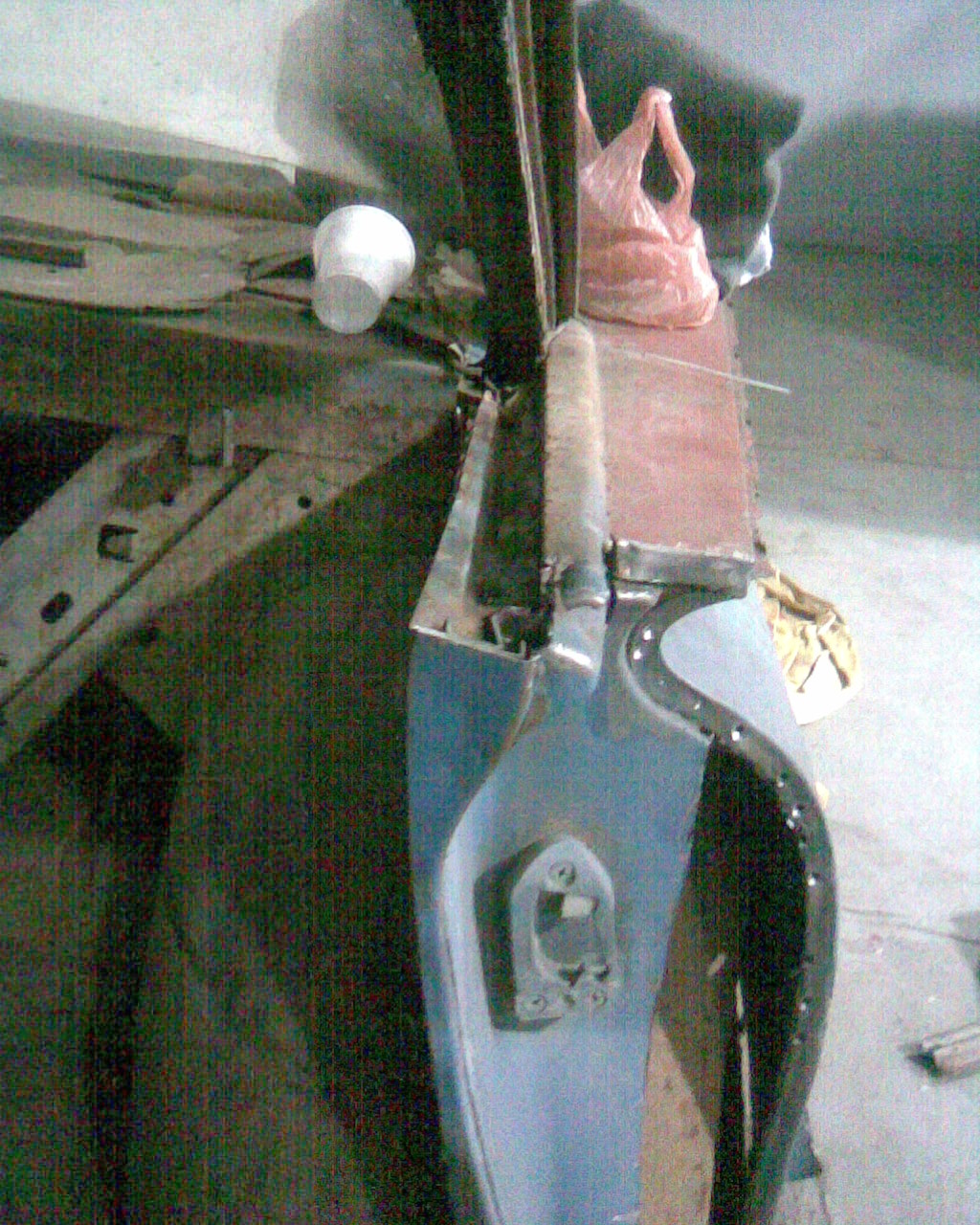

  22. Hi Steve! Thanks a lot for the info!! Still working a few hours on the car... Still waiting the MIG...

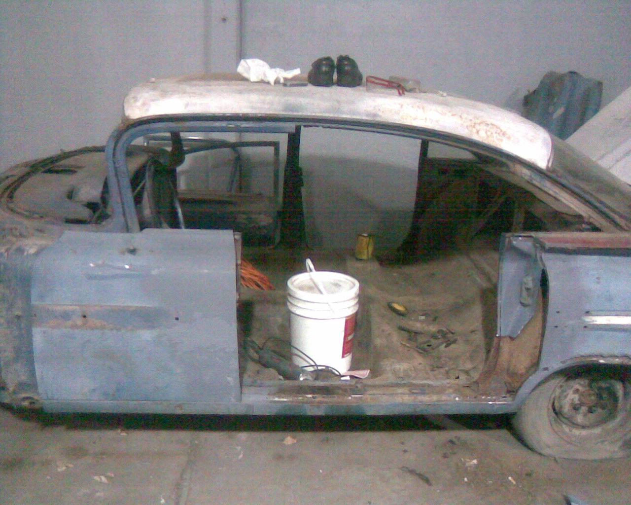

    I would like to know how did you manage to cut the quarter glass section... ( image 2 )

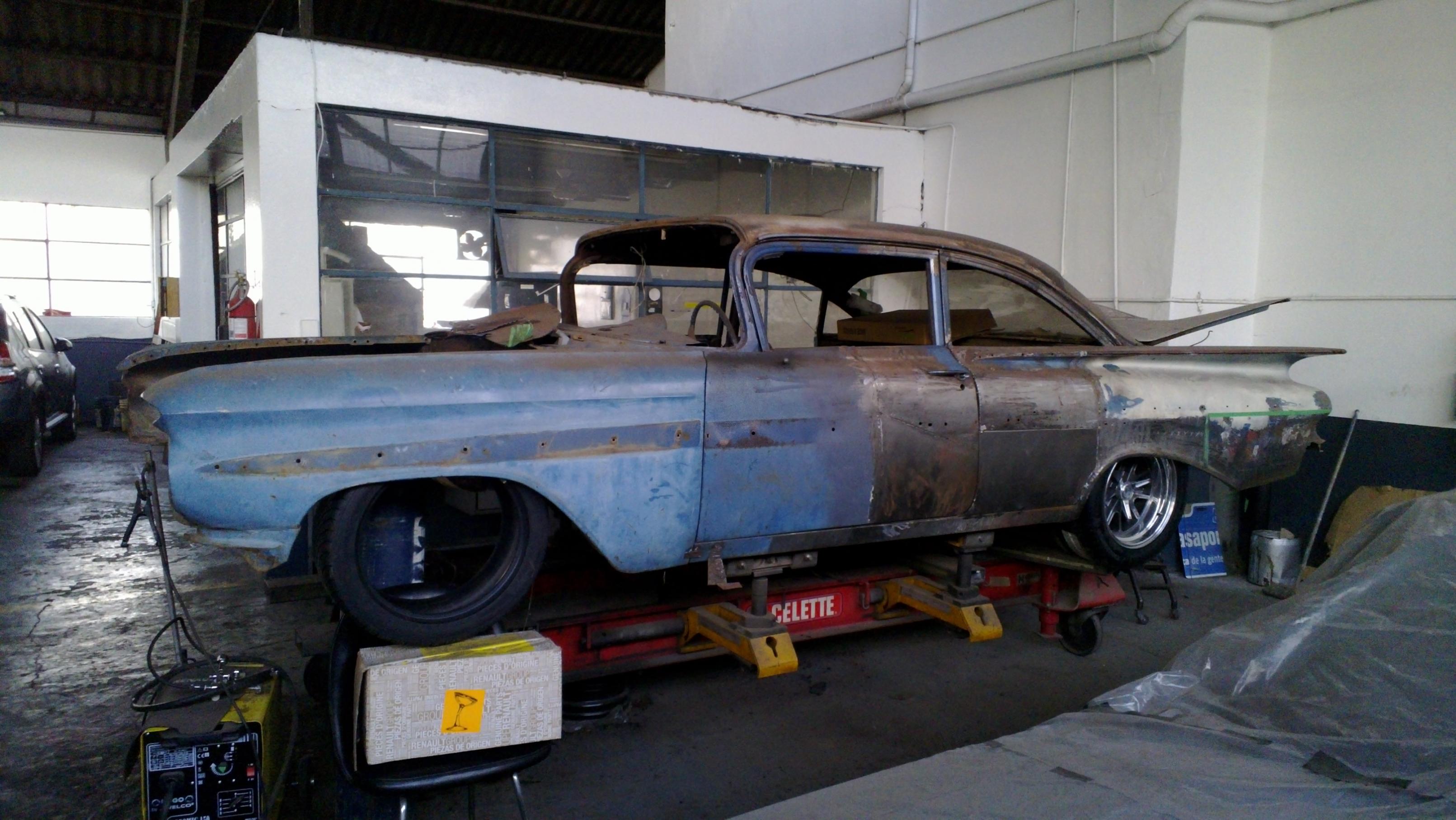

  23. Trying again... But now I leave all the job to Viejo Paz!!!

  25. some little progress on rear quarter window!
