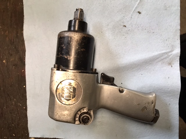

    A5F16D84-810A-47A7-B66F-67D9567F3B27.jpeg I have a NAPA impact wrench I’ve been using for 30+ years that suddenly stopped working. It sounds like it is running on low air pressure, it turns slowly and does not energize the hammers.
    The manual mentions a filter/screen under the air connection but the fitting seems to be frozen/seized in the handle and I can’t get it to turn.
    The manual also gives a part number for a repair kit but the local NAPA store hasn’t responded to my request.
    I’d hate to toss it for some minor repairable problem.

    That is a re- branded Ingersoll Rand ir231.
    Parts are readily available.
    Hammer pins are the common thing to break. Cheap to repair.

  21. They are rebuildable, and it might just have stuck vanes, or air leak inside. Try running Marvel Mystery Oil in through the air inlet. Letting it soak for a while. Sometimes, that will loosen it up enough.

    I'd say if it worked good one day and then started messing up the next I'd bet a stuck and or dirty vanes.
    First thing I do is no air, pull the trigger, insert carb cleaner or brake clean nozzle deep into air inlet and pull trigger until fluid and dirt come out vents. After a minute or so I then go to wd40 for a minute or so.
    Once I've done that, I hook up the air hose and pull the trigger. Let it run a few seconds then hit reverse, do it a couple times. Once that's done then I put either trans fluid or air tool oil thru it and pull the trigger, forward-reverse a few times and it's usually good to go.
    If that doesn't work, rebuild time or replacement....

    That looks like an Ingersol Rand, probably relabeled for NAPA. They are good impacts, I'd get it rebuilt.

    If air blows through it with no anvil action, the problem is in the hammer side, not the motor side. Counter intuitive, I know.

    Been busy today, just saw replies, in no particular order-
    Oiled regularly, dry air maybe not so much.
    Had it apart, nothing broken, everything clean but oily, no dirt/sludge. No stuck, broken vanes.
    Tried to take air valve off, it is held on with small hex socket, can’t turn it
    Motor spins, but slow, sounds like it’s running on about 30 psi, wonder if I’ve got an air supply problem?? Blow gun seem to work OK but maybe not enough volume.
    Gonna take it apart again, try to blow air back thru valve and inlet in slight chance something is clogging air passages in gun.
    Thanks to all for replies.

    Like most stuck things, "HEAT IS MAGIC"!
    Many air tools have fittings that are installed with some type of sealer. To break the bond, heat the housing where the fitting goes in. You're not trying to melt it, just warm it enough to 1) make the sealer give up and 2) expand the aluminum housing away from the steel fitting. I use the '3 times is the charm' method. Heat it, let it cool to the touch, do it again and on the third heating unscrew the fitting. If that doesn't work, send it to me and I'll remove the fitting and send it back, no charge!
    If you have a temperature gun, 350 is the good number for aluminum.
