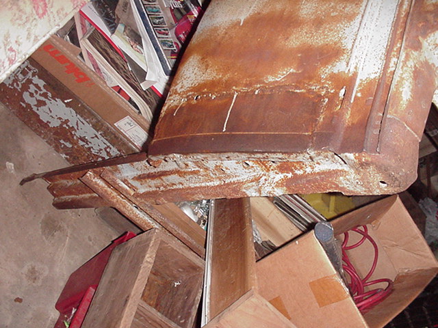

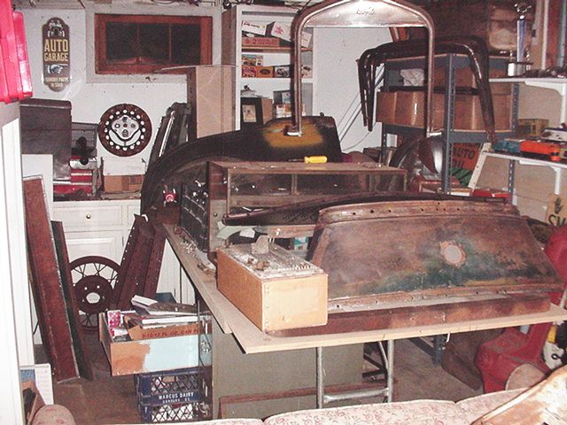

    The goal this weekend is to organize the basement and find all the bits to my '30 Roadster body.:eek: Found the body in 1962 when I was 11, sold it around 1976 got it back 25 years later, and it really hasn't changed much since. Wish me luck.

    Thanks Dan, reading your build history got me started on mine. Spent two hours down there, half filled a trash can, got boxes for copper, aluminum and steel scrap, tools and future eBay items. There is a 6x6 feet of open concrete floor space now. Once I have the area clean, i start on the projects history. Bob

    Ok, that 6x6 section of floor got covered by more stuff I moved around. I did selloff $100.00 worth of unwanted odds and ends, so that is progress. Almost have the subrail setup table uncovered. Sure would be nice to have the cowl frame blasted and in primer with the Brookville cowl sides attached by Christmas.

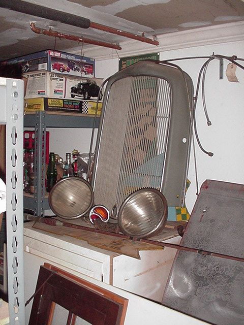

    That '32 Ford grille incert has been hanging on my wall since 1961. I'd bought my first issue of Hot Rod in June, and built a few AMT models to know what parts were. When I spotted it hanging in a friends garage I had to have it. Back then 10 year olds didn't have money, so Peter came over to my house to look for something to accept as a trade. Dad had just washed the both floormats out of the new '61 Ford, they were sitting on sawhorses and all dryed off. That was the deal maker, he took one and I took the other and we bicycled back to get the '32 incert. That night at dinner Dad asked how my day went. I had to admit that without asking I'd swapped his month old floormats for a '32 Ford grille incert.................Turned out Dad didn't like the one piece mats since they didn't fit nicely over the tranmission and he had replaced them with 4 small ones. He liked the grille, and told me he always wanted a '32 3Window.

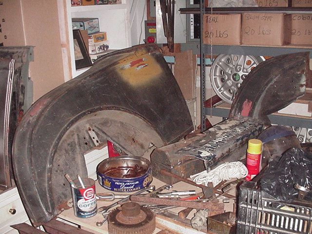

  22. just a quick question
    what is 20lbs of teal?
    lol
    i am jelious that your wife will let you weld in the basement, by the way
    tk
  23. The37Kid
    Joined: Apr 30, 2004
    Posts: 25,894
    The37Kid
    Good eye!:D I've got 20 pound boxes of "Sea Glass" in different colors, it is used for artwork projects. It is a slow seller. Got it from a friend that I've known since 1968 when he cleaned out his shop. If someone buys the stuff I'll have more Roadster part storage room. The fire hydrant to the right of it is one I restored, and it is a keeper. My wife is the Greatest!

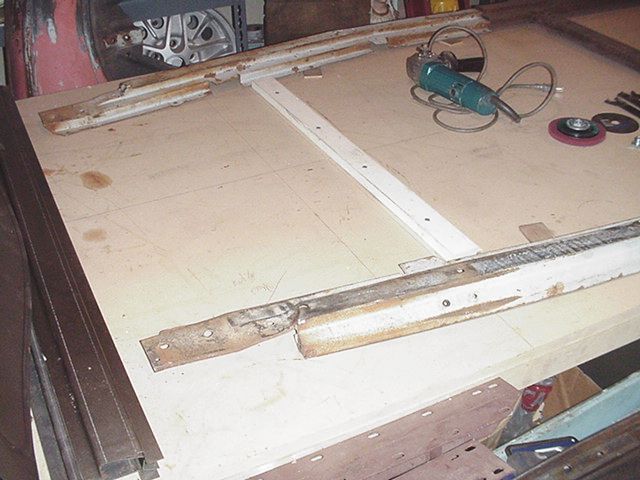

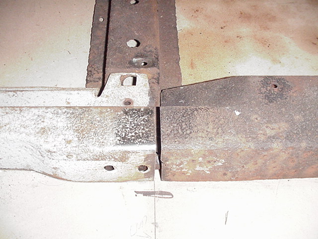

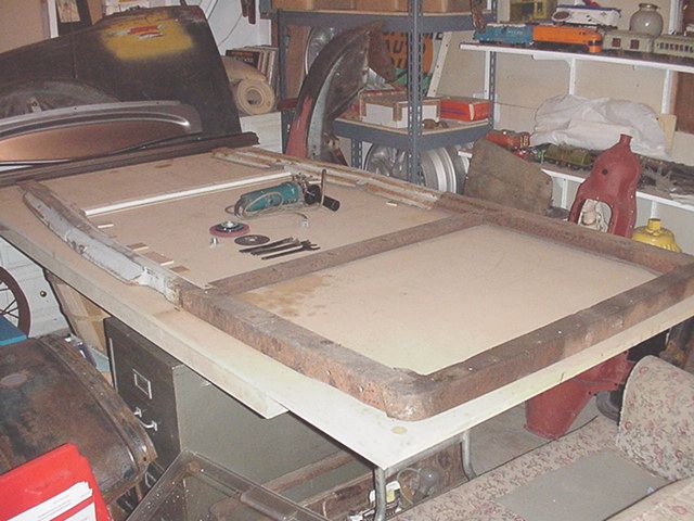

    All the junk is off the subframe alignment table! When I found the body it had been channeled, and the doors were welded closed. Some time in the 1970's a good cowl and passenger door was swapped out for the old pieces. I had main rails that went from the cowl to just past the door openings. Using the good cowl subframe that was still attached for a base I screwed it to the table after squaring it up to the table. Traced the inner and outer edges, and body mount holes. This allowed me to place the main rails on the table, and square them up. Note the 1/4 plywood blocks on the inner edge to keep them level. The missing rear section came from the estate of Dick Greene, a guy I'd known since the early 1960's. He was the first guy I knew with a vintage Dirt Track race car, this really impressed me and lead to my Ford Four Banger collecting. The rear section was measured and cut to fit the main rails. The body will go on a '32 Ford chassis and I'll be using the kick up subrail sections Vaphead makes, but I need to have a dead stock body set up first. Once the body is in primer the kickups will go in.
