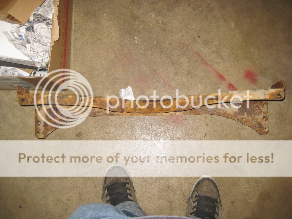

  11. Thought you guys might want to see the F1 frame and crossmember after I drill out all the rivets.
    here is the free frame
    and the crossmember out
    also NoSurf sent me these to help repair the f-ed chop. Thanks dude!
