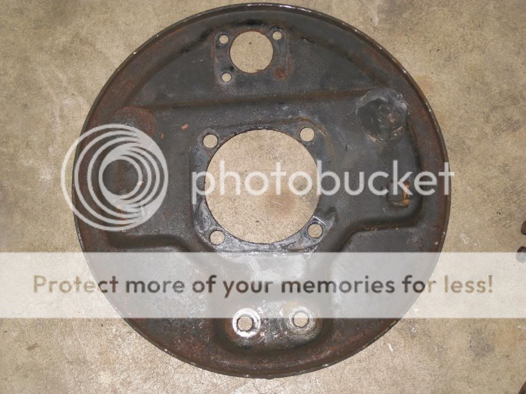

  24. So today I took both the front drums off of the spindles.
    It was a real bitch since they weren't on the car. Also I guess I don't understand how the shoe adjusters work. I tried to back the shoes off but I didn't notice a difference. One side came apart without to much fuss, but the other.... It probably didn't help that the drums were pretty rusty on the brake surface area.
    On the other hand, The shoes look like they were assembled and never run. They have a ton of thickness left.This is the worst one.
    I decided to take everything apart so I could clean it. I got wheel cylinder rebuild kits order at the local parts store at $6 bucks a piece. the spindles look amazing. the backing plates look really nice. I'm very happy with the condition of the parts.
    So I am wondering do you guys think I should run the shoes if they clean up? They look ok, like they have never been run, But have rust stains from the drums. I'm worried about the bonding being compromised. Better to be safe then sorry right? I have a local Friction guy right by my house, I'll have him check them out tomorrow. Also do you think the drums look bad? What are the max size specs so I can turn them? Also I am about to mock up the suspension. I want to get some new spring perches, shackles and a spring. I need a spring that matches the axle right? Or will an A spring with 36 front axle work. Were is a good place to buy suspension parts from? I prefer to support a hamber or local. thanks.

    I'd give the shoes a LIGHT sanding with 80 grit,just enough to remove the crap and check for any other contamination(oil etc)or signs of the lining lifting away from the shoe.Drums may clean up O.K. with emery cloth.But,as with anything to do with brakes,if in doubt,either get someone who knows their stuff to check them or replace.
    To determine which length front spring to use on a spring over set-up,measure between the centres of the perch pin bosses on the top surface of the axle then subtract 4 1/2 inches.That will give you the required free length of spring.

    i wouldnt run those brake pads. old brakepads come apart easy.
  27. thanks again Mark!
    Yeah, that is my fear too. I am worried the bonding agent is compromised. I'd hate to have the friction come off and ruin a good drum. I'm probably going to have them redone.....
    Anyone have any recommendations on where to purchase shackles and perches?

    i wouldn't run those shoes either, i have had one shoe come loose and jab between the other shoe and the drum, locked the wheel up, looks like a fun build, i have a 31 waiting for it's turn in the shop myself.
