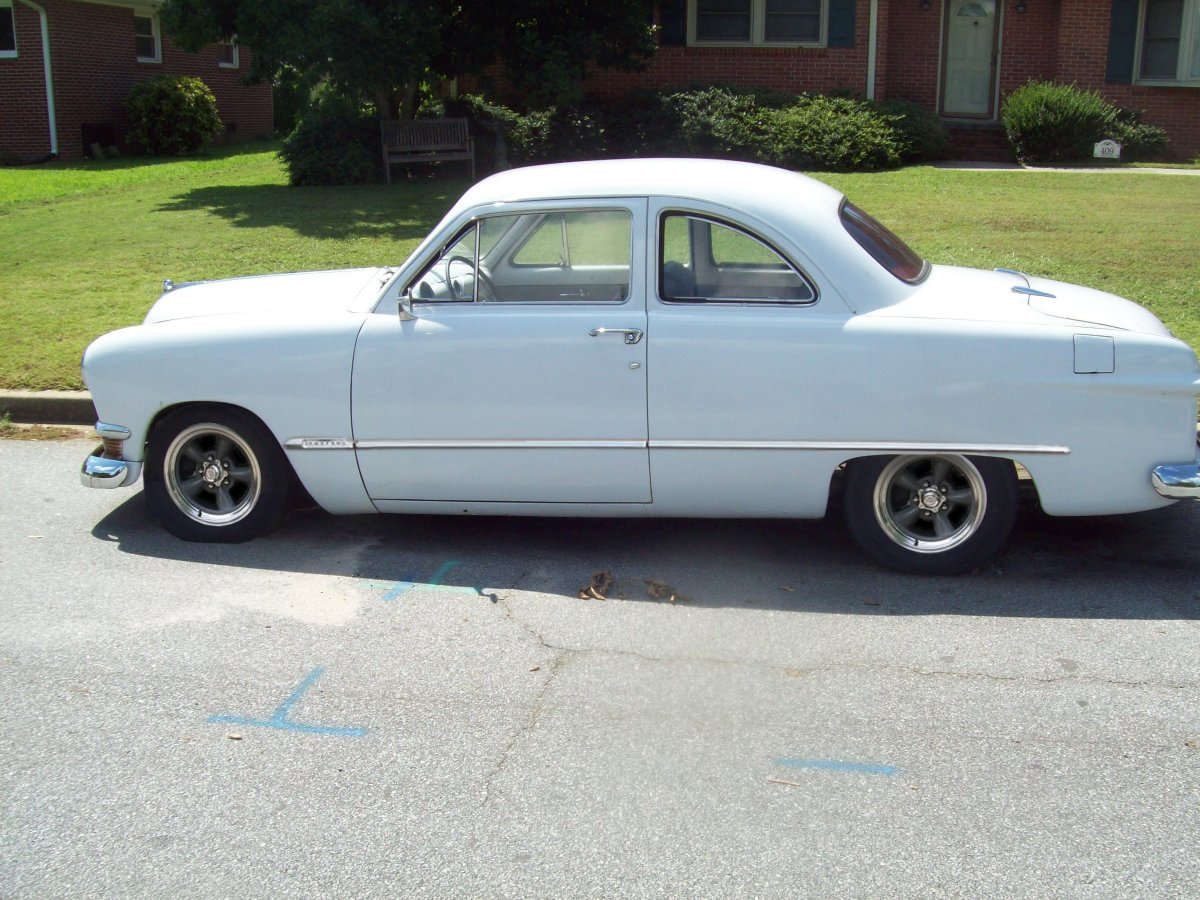

  9. Yes sir, Moose did a photoshop for me adding the wheels & side trim and I really like the look. HRP
    BLUSHU, 3W JOHN, 4tford and 3 others like this.
  10. I like your photoshop version. I just happen to have a set of early 14" American Torque Thrust wheels. They just didn't quite work for me on my 51. I liked the hub caps better.
    The Wizzard
    3W JOHN and HOTRODPRIMER like this.
  11. Thank you sir, I like the hub cap version also but I have had this vision in my mind for a long,long time. HRP

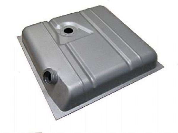

  14. I discovered today the gas tank is shot,the metal is weak on the bottom do I plan on replacing it.
    I haven't started looking yet but if anyone knows of a original replacement type let me know. HRP

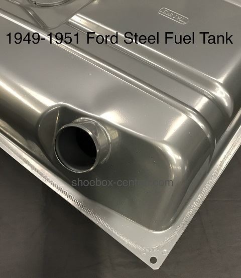

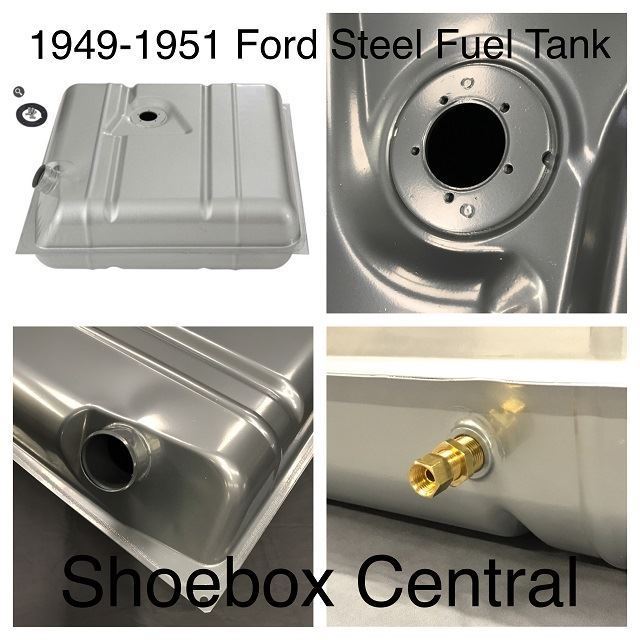

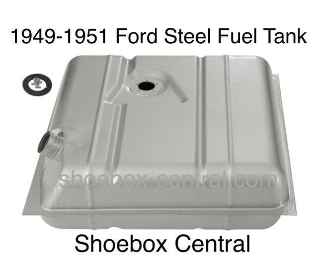

  18. Not the worst price, do a search on the Ford part number. C & G Ford is the same $$. I find a lot of new and used Ford parts on eBay too. Spectra Tank probably makes them, look up 51F and you may do better.
    http://shoebox-central.com/1949-1950-1951-ford-fuel-gas-petrol-tank-steel-metal

    Quite possible, the new gas tank guage opening is a different size than the original. You will need a new sender to match the new tank.

    I used a Mustang tank in my '50. I'll have to check inventory on all my extra junk.

  22. I'll add just a bit more First Hand info about my remarks on the Gas Tank. I have bought tons of parts from Dennis Carpenter for years. 99% of his stuff is right on, no issues. That covers 3 of my 57 Ford cars, 3 51 Ford car projects and 2 F-100 projects among others. The Fuel Tank I got with his Co. name imbosed in it just missed the mark. The Tank itself was just oversized enough that the stock straps couldn't do the Job. Once past that issue it also was necessary to adjust the opening in the Floor where the Fill Hose coupler enters the Trunk. That showed that the fill tube receiver was at a different angle than stock. Once that was done the fill tube had issues fitting back in the hole for the rubber seal below the fill cap. All 3 of these things were just off enough to not be a good deal and P----ss ya off. R & R of two straps and a Hose clamp shouldn't be a big deal. Then when I went to run the line nut into the fitting in the Tank it was going to take digging out what ever was in the threads so the nut would start. I pulled the plug and boxed it back up. My Vicky has a tank from Tanks, it was a direct drop in. I ordered another from them and had ZERO issues on the Vert. I just did another on the Sedan. I have no idea who actually builds the Tanks from Tanks but they fit as in Stock replacement. That's the way it should be.
    The Wizzard
    3W JOHN, jim snow and HOTRODPRIMER like this.
  23. P.S. The stock factory 51 sender fits correct in the Tanks tank.
