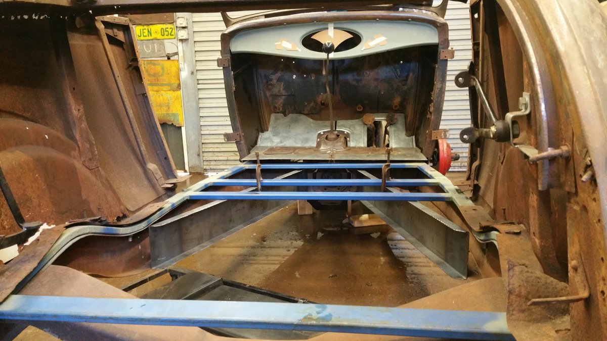

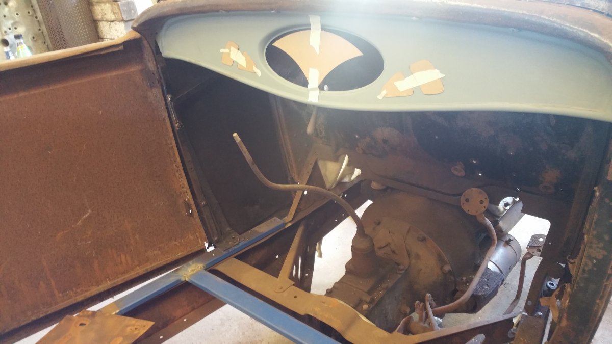

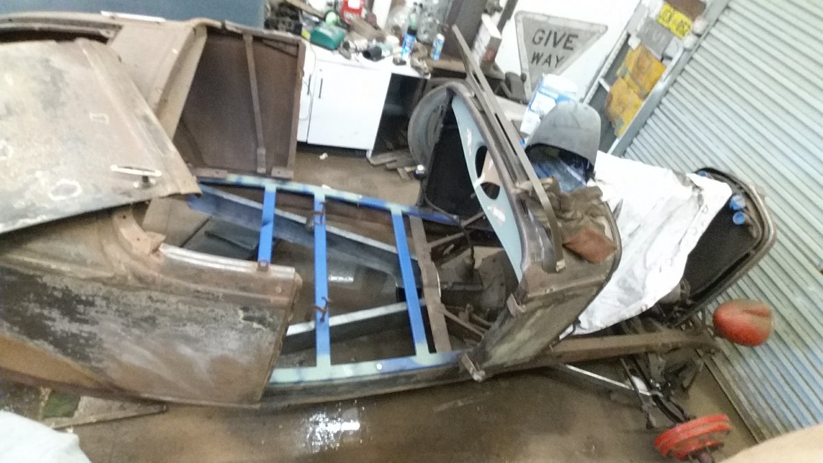

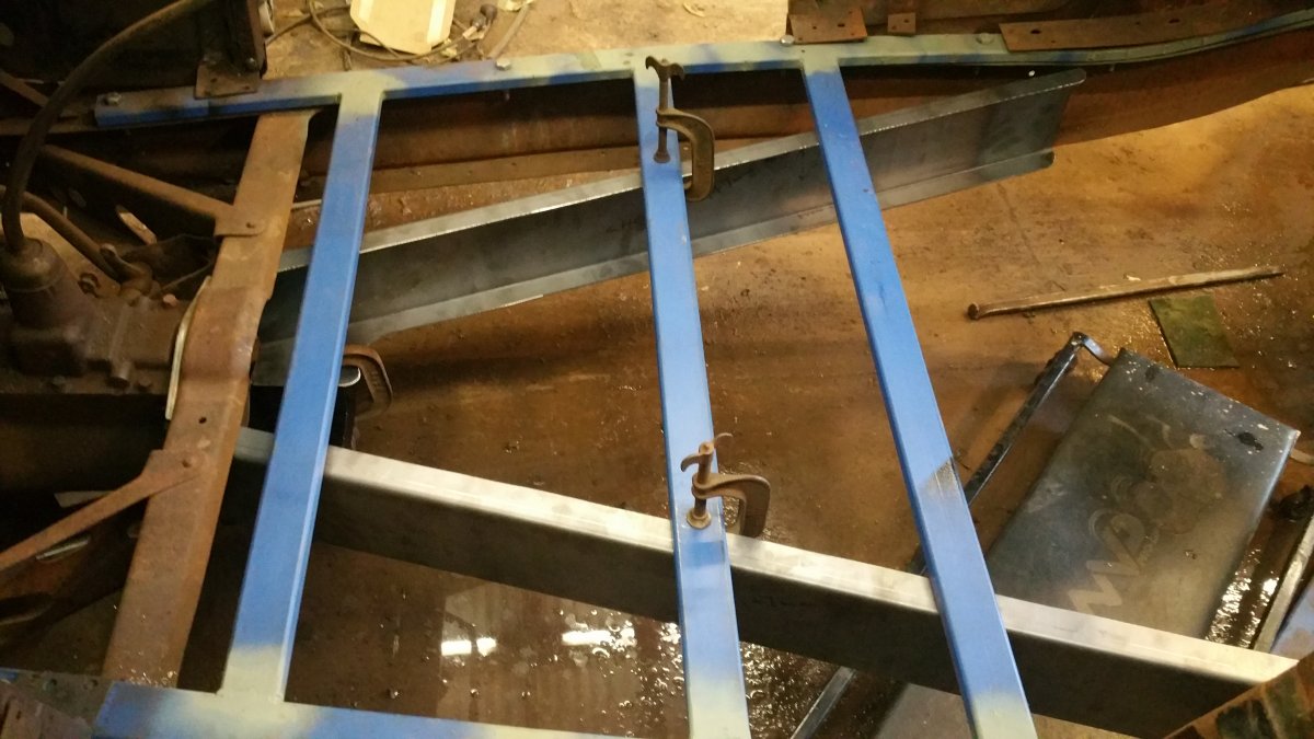

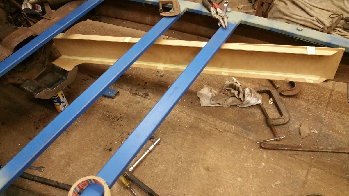

    I cut the sheet metal for the "X" member legs and dropped them off to be folded today. Pick them up tomorrow.

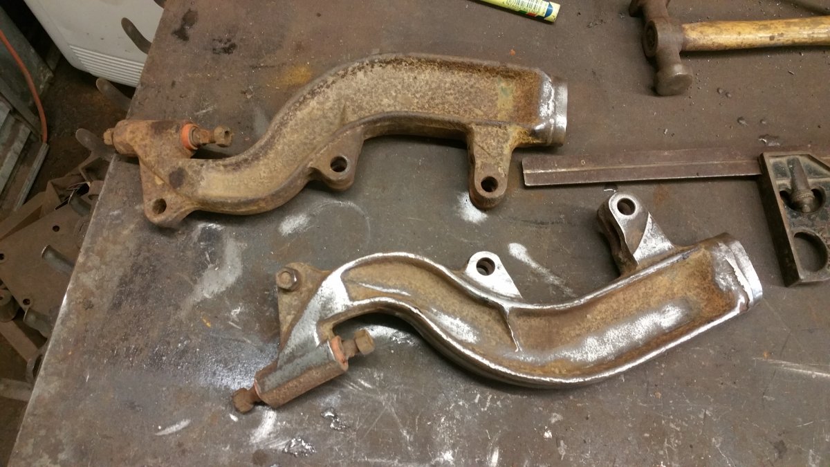

    I started cleaning up the 34 wishbone I got with my flathead engine haul a while back. I'll have to extend it the 2" required to make it fit the 32 so I'm hoping to find some suitable tubing tomorrow at the local steel supply store. 20180718_152807.jpg 20180718_173351.jpg

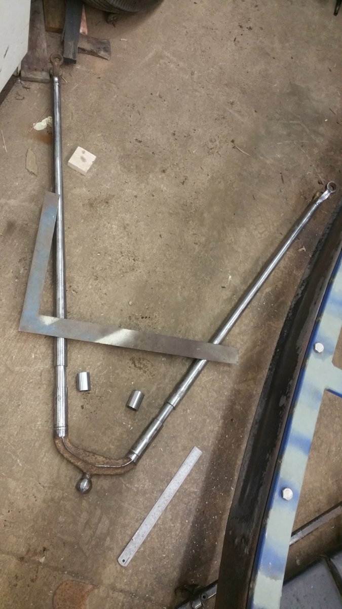

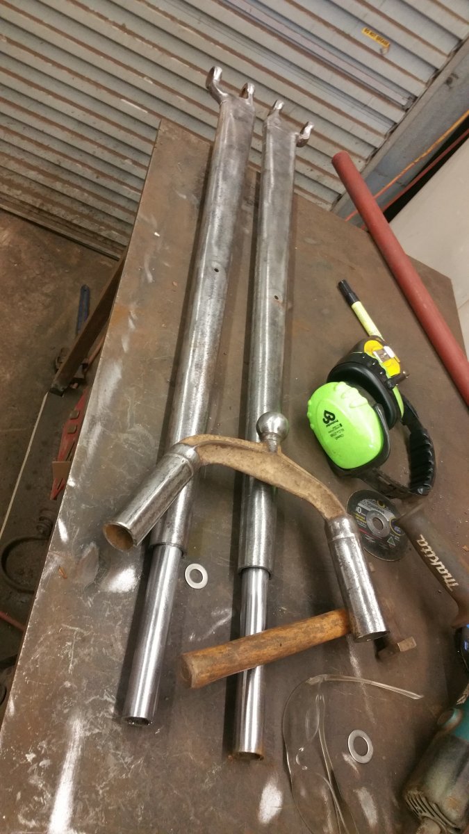

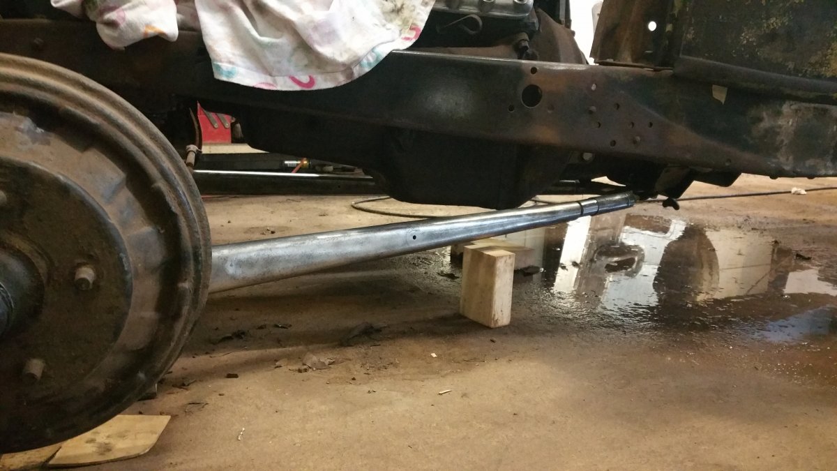

    Got my folds back this afternoon, with some more cuts and holes for exhaust to come before fitment. Also made some progress on lengthening the wishbone.
    I purchased a pair of chopped up 36 radius rods at the Ballarat swap meet for cheap, with plans to use them on a later project. With the heavy pitting on my complete radius rods I've decided to repair the hacked ones which have no pitting. I purchased some tubing and will make them the length I need. 20180719_144855.jpg 20180719_144011.jpg 20180719_142549.jpg 20180719_142506.jpg 20180719_142440.jpg 20180719_120758.jpg 20180719_113525.jpg

    Wow. love this dash layout! Not sure what you were going top do, but this is beautiful!

    Dereald, If you are referring to the hydraulic brake system sold by Gene Sanders I would not advise anyone using his system. I installed the bracket and arms on my original roadster and fortunately for me one of the arms broke while bleeding the system in my shop. I called Gene and forwarded photos of the broken part and he was very surprised. The brake system arms were cast from aluminum and due to the absolutely wrong material and a stress riser the part failed. Had I been in traffic my car could have been potentially totaled. I sent Gene the attached photos, one of the broken arm and one of the replacement arms I had a local shop make. Brake systems and steering components are the most critical safety devices on a car and should be manufactured of the highest quality materials available. IMG_0568.jpg IMG_0575.jpg
