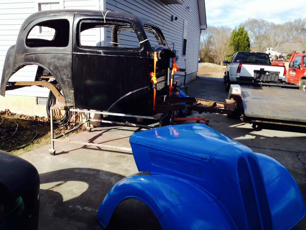

    To brads comment about having fun at the local races, he is dead on I picked up a 48 Anglia project in of all places in a small shed in downtown marreta, ga last nite gasser project!

    ImageUploadedByH.A.M.B.1421584278.417353.jpg ImageUploadedByH.A.M.B.1421584300.886167.jpg
    Frame is pitted, will probably build a 2x3 chassis
