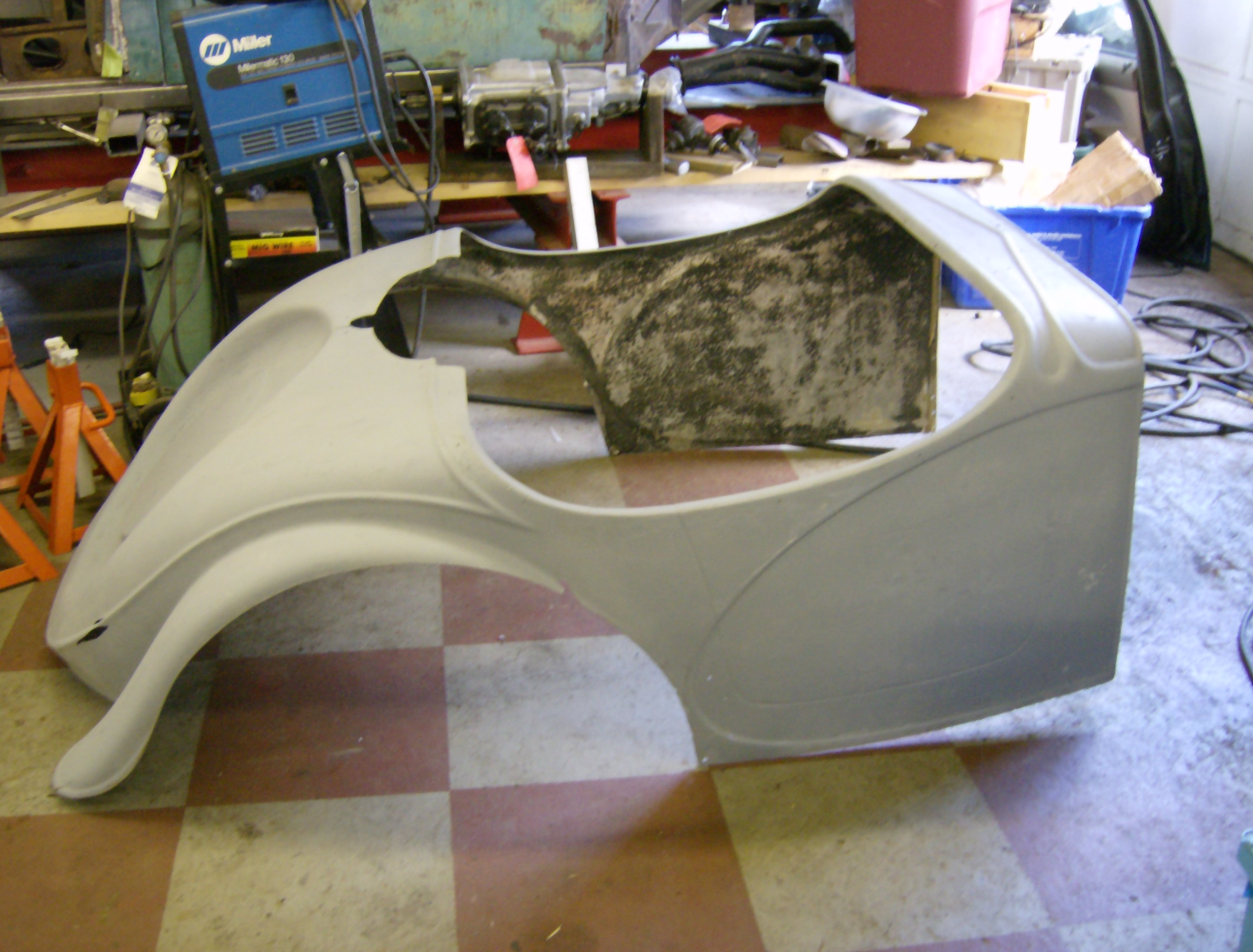

    1. Early Hemi Tech
    I bought this one a couple weeks ago at the NEHRR in Epping. Bantam 003.JPG Bantam 004.JPG
    It will be going on a R-16 style chassis.
