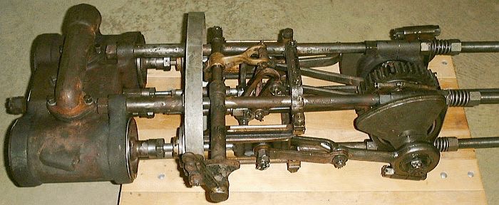

    Here are some photos of my late uncles 1911 Stanley Steamer. It was the only one of this body style built in 1911. I went though all the valves and pumps replacing seals and packing. Then went though the engine/motor, and finally through all the plumbing to get ready for a season of driving. He always claimed 1 hour of driving equals 4 hours of servicing!
    This car used unleaded gasoline as fuel under 60PSI of pressure, run though the fire box to vaporize it. The steam pressure was 300PSI at all times.
