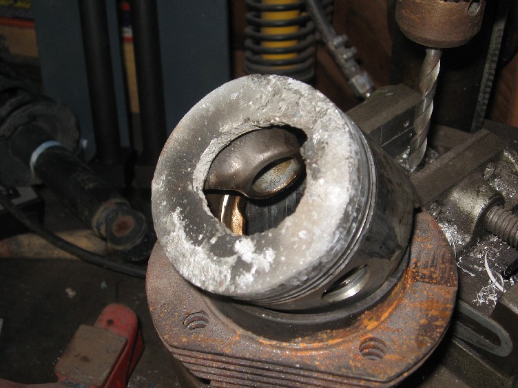

    Usually, too much timing in an engine will cause pre-ignition, also called detonation.
    Most of teh time, detonation will make a hole in a piston top before it scatters the engine, but detonation is also very hard on the upper rod bearings, which is not good for teh long term future of the engine.
    It can also dick up the piston ring lands, which can sieze or break the top compression ring. Sometimes, it can pop a headgasket, possibly resulting in anti-freeze entering the oil, not good for bearings..
    So the question is, did timing lead to kicking a rod out of teh block? Probably not, but maybe...
    Good luck, -Abone.
