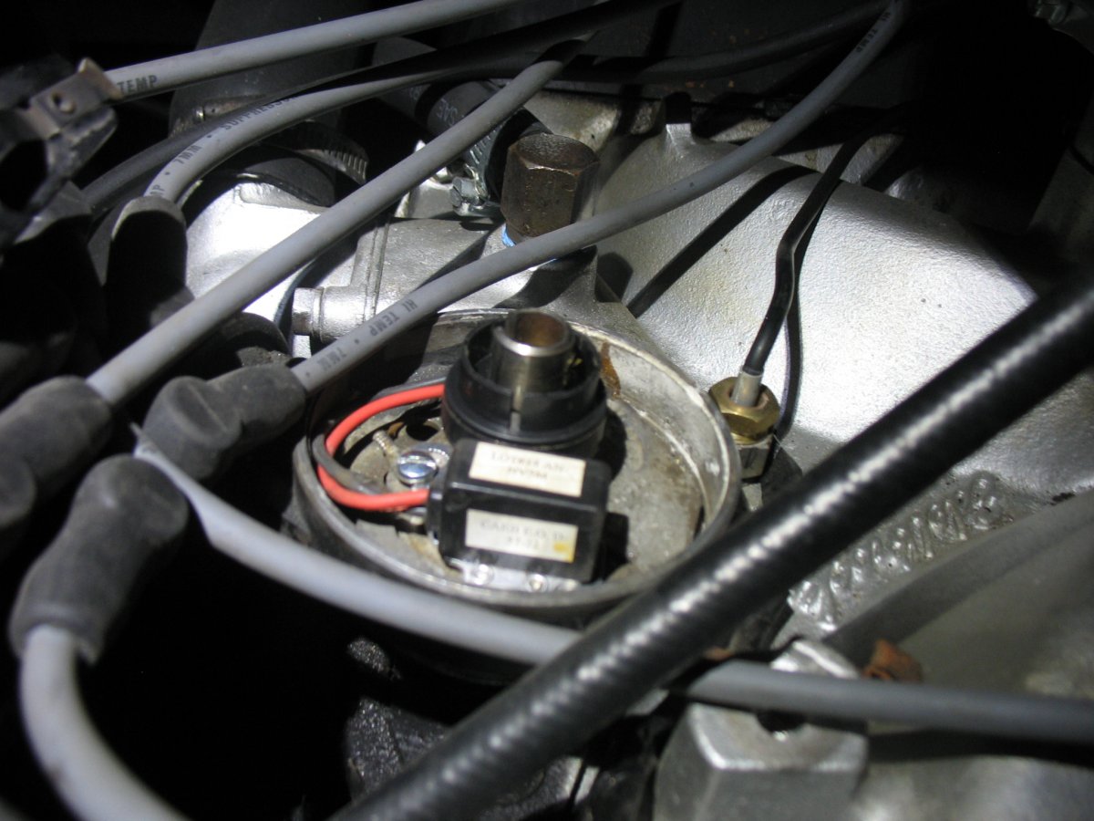

    So I'd like your opinions if you agree with my assessment. Ballast resistor tests OK and is hooked up solid. Rotor spins when the motor is cranking, cap and rotor look new. Coil tests OK. Wires look new. I performed the test third post down on this page
    https://www.jalopyjournal.com/forum/threads/testing-a-pertronix.363494/
    and came up with .1 to .2 volts no matter the position of the magnet sleeve.
    I am posting two pics, one with the magnet sleeve in it's normal position and one with it upside down in order for me to perform the test. I had to flip it upside down to perform the test, is that correct? Would that still give me good readings? Also does this test pertain to my system?
    I am thinking the ignitor is the issue, what do you think? If so what is the best replacement part?

    Oh, forgot to mention, there is .030" gap between the sleeve and the ignitor. Also she is getting gas, and tested the spark and it is definitely a spark issue.

    I would suspect it as well. FYI, the magnet sleeve being on upside down will not give you a valid reading even if the ignitor is good. Why did you flip it over for testing?

    Appreciate all the replies. From the testing I did and the replies here, I went and bought a new ignitor today. After I installed it I turned the key fully expecting to hear her come to life, but nothing... So for grins I tested the new ignitor the same way I did the old one (per the link I noted above) and got the same results, as if the new one was bad also. I am following those instructions to a tee but since I've never done it before and never seen what a good one looks like, I am not 100% confident in the results. To answer Ebbsspeed's question, I flipped the magnet sleeve over so I could spin it for the test. The magnet "strip" was in the same relative vertical position to the ignitor upside down as right side up so I figured it would work but let me know if I'm wrong. I saw another idea on youtube to stick a screwdriver between the ignitor and the sleeve and that should change the reading also, so I tried that with this new one (with the sleeve right side up) and got the same readings: about 0.15V no matter what.
    I have tested the coil, ballast resistor, connections are good, cap, rotor, wires look new, .030" gap between ignitor and sleeve. I have to wonder if this new ignitor is no good. It would not be the first time I bought ignition parts bad out of the box. What else is there?
