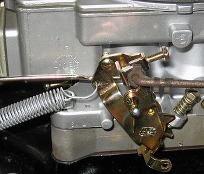

    It's fairly easy to figure out what you have and what the cfm/size and application were by looking for the stamped numbers found behind the accelerator pump.
    There will be a clock face with the primary venturi diameter number stamped inside of it.
    1.08 (480cfm) and 1.12 (600cfm) are the norm, 1.19 inches is the 670 cfm (good luck in finding a 670!)

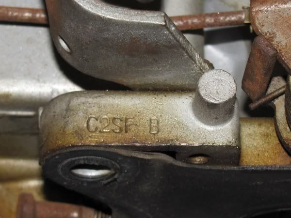

    Just below that (on the mounting ear) is the actual part prefix (application/specifications number) which will tell you what engine and car the carb was designed for.
    You can use the info (Below) and at this link to decipher the Part/Spec number:
    http://mustangtek.com/4100/ford4100.html

    C2SF-B
    Unconfirmed Application. Information may or may not be complete or accurate62 390 Thunderbird
    1.12 venturi 4V
    600 CFM
    Auto

    Dash Pot
    Autolite 4100 Dash Pot
