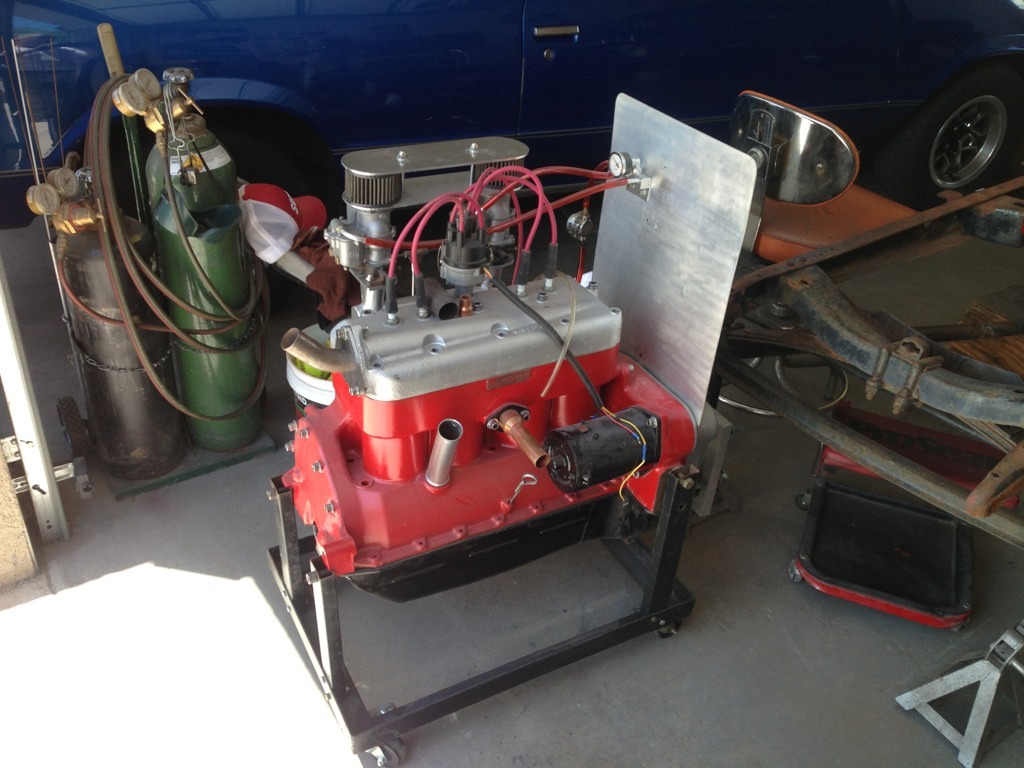

Here's mine. My buddy craig and I are building a banger powered roadster. Yes twice the money for one third the hp. This is a stock, empty block. It was in a deuce one ton truck. It is a model b. we got it and a crusty but "rolling" model A frame for nothing. Oh and another A engine and trans. I had a glass 27 roadster body in the back yard. We are into this project cheap enough that we can spend some bucks on the power plant. The B is the holy grail of bangers and this one is unmolested. z'd the rear. Ordered a new 4 inch dropped front axle. we wore out one wire wheel. just cleaning and rattle canning. I highly recommend brierlie's book. A banger project doesn't have to be expensive. Skip the overhead for now and shave some off to get a little compression in her. If ya can't add hp then add more lightness. We wanted something to putt around town in, cruise in, and run at vintage hill climbs. Look around before you drag out the checkbook. Posted using the Full Custom H.A.M.B. App!
To me hot rodding is being creative and scrounging and not spending a fortune. Be patient. Talk it up with friends. Go to swap meets. It is car-ma when it all comes together for you. Posted using the Full Custom H.A.M.B. App!
Btw that is an iron head painted to look like aluminum. 94's on a home made manifold. I want a double overhead Hal but it is the champagne thirst on a root beer budget. Be real be patient and lament with your barber. That's what I did and he got me going in the right direction. Posted using the Full Custom H.A.M.B. App!
