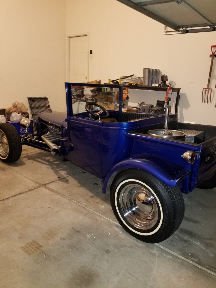

  1. I purchased this bucket recently . I need help identifying it. What year/model do you think it is?

  6. Here are a few more pictures .

    The cowl is 28-9 model A. Looks like it was built using a sedan back grafted to a coupster front.
    r
  8. Thank you for your insight . It was sold as a 31 model A, but I couldn't find anything that resembled it via the google searches.
  9. They do not look like Ford body parts to me.

    With that cowl and body no way do I believe it is a 31 Model A.

    Definitely not a 28-29 model A cowl, looks a lot like 25-26 dodge

    I have to agree upon a second look at the cowl that it’s not a Ford cowl.
    r
  15. I have seen doors on a model a that had the same features but the body seems different. The 29 model a Ford roadster pickup is the closest I can match it to. I will look at the dodges from that era.

    It's not a Ford, a 31, or a T bucket. Do not drive it until somebody qualified and experienced with old cars checks it out. Cause that front end.....to start with no way looks safe. I don't care how many miles whoever drove it etc. It may be a super fun car and a great deal, whatever. Have it checked out BEFORE you drive it.

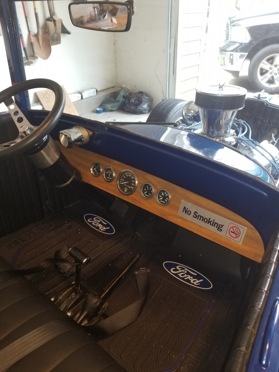

  20. The bed and fenders are aftermarket but are metal.. No fiberglass . Part of the area behind the Firewall seems to have been replaced . The body is all metal and is mostly original
  21. Love the wood grain dash!

    Nothing "standard" about anything that someone built. The shock shafts are rusty and I bet the mounts flex more than the shock works, the drag link rod end looks like it's almost all the way out of threads, and maybe doesn't have a jam nut on it, the tie rod is bent, the steering arms on the spindles will provide you with very bad steering Ackerman, that's just what's visible on a quick pic look. The car looks like it was driven tons based on the paint chips to all the suspension, but that doesn't mean you'll be as lucky as the last guy. I see what looks like weirdness under the steering box area at the frame Z.
    I know you asked for help on the ID not a critique of the car, but being it's your first, keep asking questions about the construction.

  25. It's a hacked up body that someone has made from(probably) a four door. NOT a Ford four door!
    The only Ford parts I can see are the Model A front axle and the engine. The rest is home made.
    As Badshifter says, please ask questions, because you need to know and you need to be safe.

    The spindle arms are NOT supposed to face forward. That in itself is a double no-no. There is no Ackermann because of that. The HAMBer who suggested you get that relic checked out should be heard loud and clear.

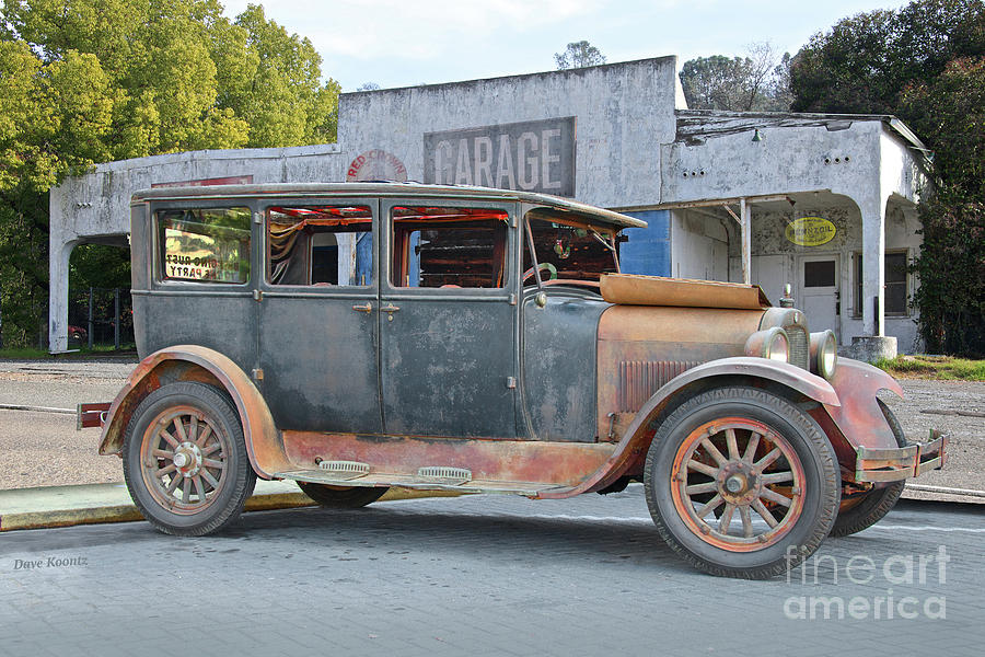

  30. Looks like the Dodge 4 dr body parts idea is right.
    As badshifter advised, you really need to check out the construction quality and details, if the builder didn't replace the drag link when it came up too short, what other corners were cut, what else was overlooked, etc.
    That is not actually a suicide front end; it is a spring over front end. Besides screwing the Akermann, forward tie rods make a statement about the builders knowledge and skill.
    Looks like it could be a fun hot rod, that needs some attention. Nothing like running down the road in a roadster (even if it has a sbf).
