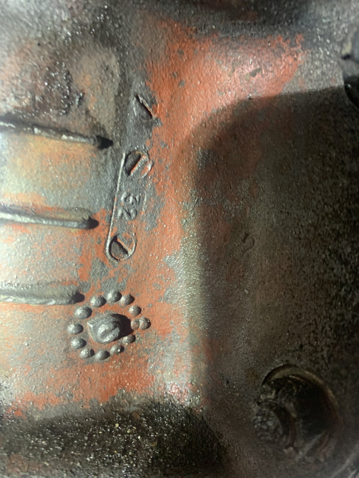

    Can the rear end be identified by the numbers in the pictures below?

    There is only one "AG" code in what I found on this site...says its a 4.11..

    and it was assembled on Valentine's Day!
    (2 14 is month/day)
