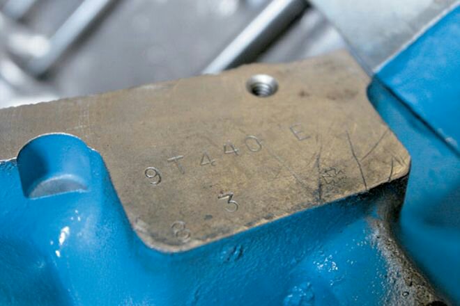

    Is the threaded hole on the machined surface where 440 is stamped for the distributor clamp? Trying to get a reference point.
  13. egads
    Joined: Aug 23, 2011
    Posts: 584
    egads
    That hole is one of 3 used to hold down the sealing plate for the front of the intake manifold -valley pan gasket. 383 does not have that cast square area.

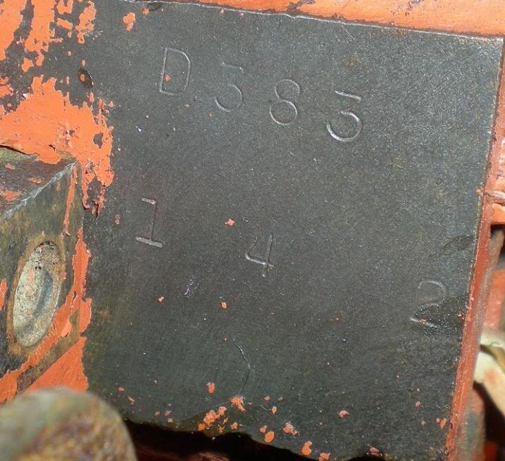

  17. Bullit68
    Joined: Sep 16, 2009
    Posts: 74
    Bullit68
    from Verona, PA
    By the distributor, just below cylinder head on passenger side.
    This picture shows a D 383. The ‘D’ is the model year, in this case 1968. 383 is the engine size. The lower 1 4 2 numbers show the assembly date of the engine, which is January 4th of 1968, and the ‘2’ refers to second shift assembly. A performance style engine will have an HP stamped here also.
