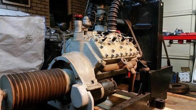

    Hey guys,
    My friend has to go to inspection for a vehicle registration for his model A with V8 Flathead, now he needs to know what year and HP for that engine. I tried the HAMB but could not find it, the number is *S54I* I Googled but the 54 and the I, I could not figure out what year, hope you guys can help. The number is between the intake and the driver head on the block. tims flathead.jpg

    Photos of the engine will help more than the numbers.

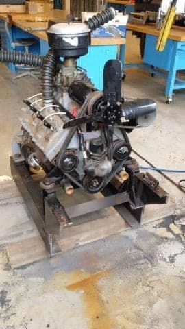

    That is the coolest pully ever! Be cool to run a blower with that! :cool: If I am correct '38-'48 24 stud flathead (59A), you can tell the difference from the 32-37 motor by the row of bolts on the bottom of the head and center water outlets. Hp was 85 in '38 and a whopping 100 in '48.

    Does it have a 59 cast in the top of the bellhousing ? In not, it is most likely an 85 hp engine from 1938 to 1942, unless it was a 99A which would be an early Mercury, not near as many as the 85 though.
