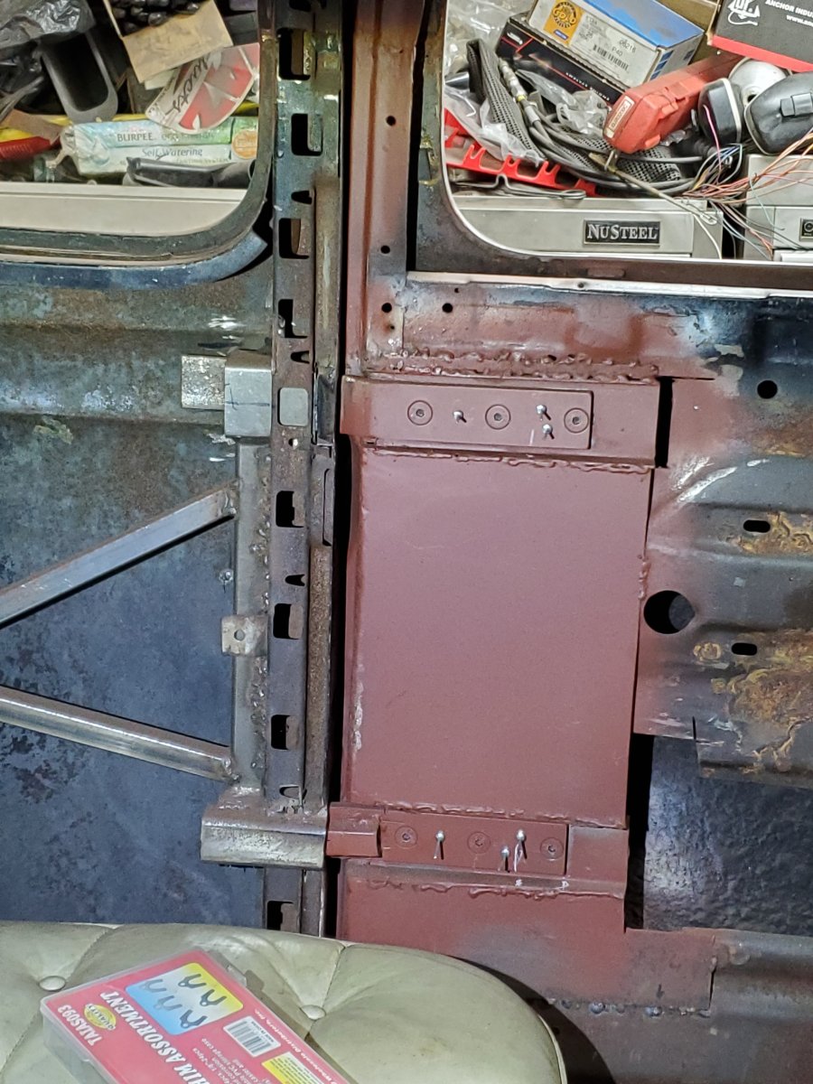

    Today I took the doors off the hinges to see how the door fit the hole untethered. I can get the door in. I get an uneven gap at the B-pillar , wide at the top tapering down to none at the bottom. On the hinges the door hits the roof on the front curve.
    At this point I humbly ask for advice on where to place the shims. Shiming the first two mounts dont make it. I know there's a science to this but I really need fast help in tweaking the body back to how it was. I really dont want to give in to my frustration and start cutting things I didn't have to. If I decide to keep this car I'll look into locating another frame or possible buy a new one. For the now I need to overcome this challenge so I move on to the floors, cowl, quarter and tail panel repairs.

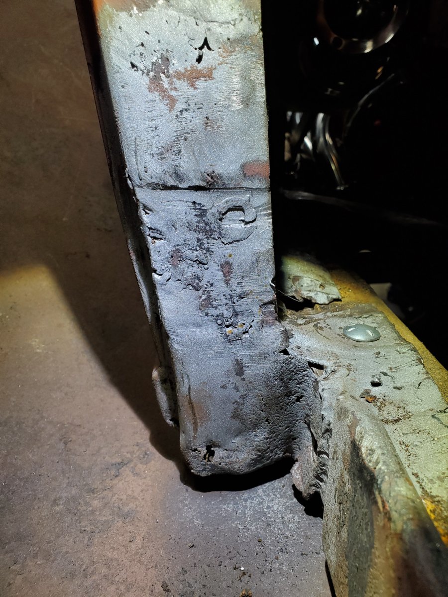

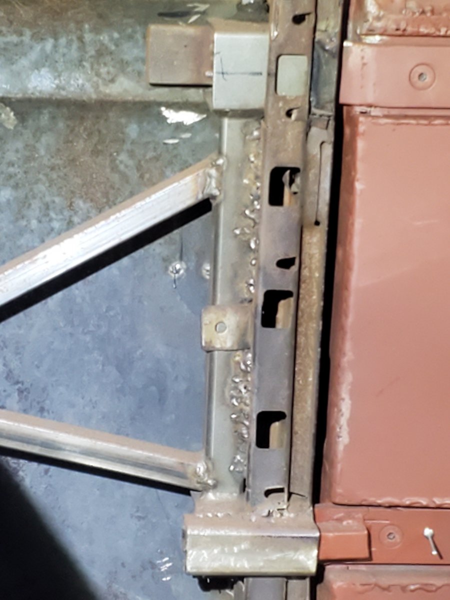

    by looking at the first pics you posted, you need to cut the pillar off the rocker. the last pic looks like somebody said fuck it, im welding it. you need to jack up the frame and make sure its level.loosen all your body mount bolts. then cut the hack welds off that corner (as well as all the other ones you can find on cowl and rocker area.). then line up the doors (make sure they open and close)and tack it in place. you may need a jack or some straps to put the body back into place. also you need good rockers before you try bolting that thing down. you have a combination of bad allignment and bad sheetmetal.
