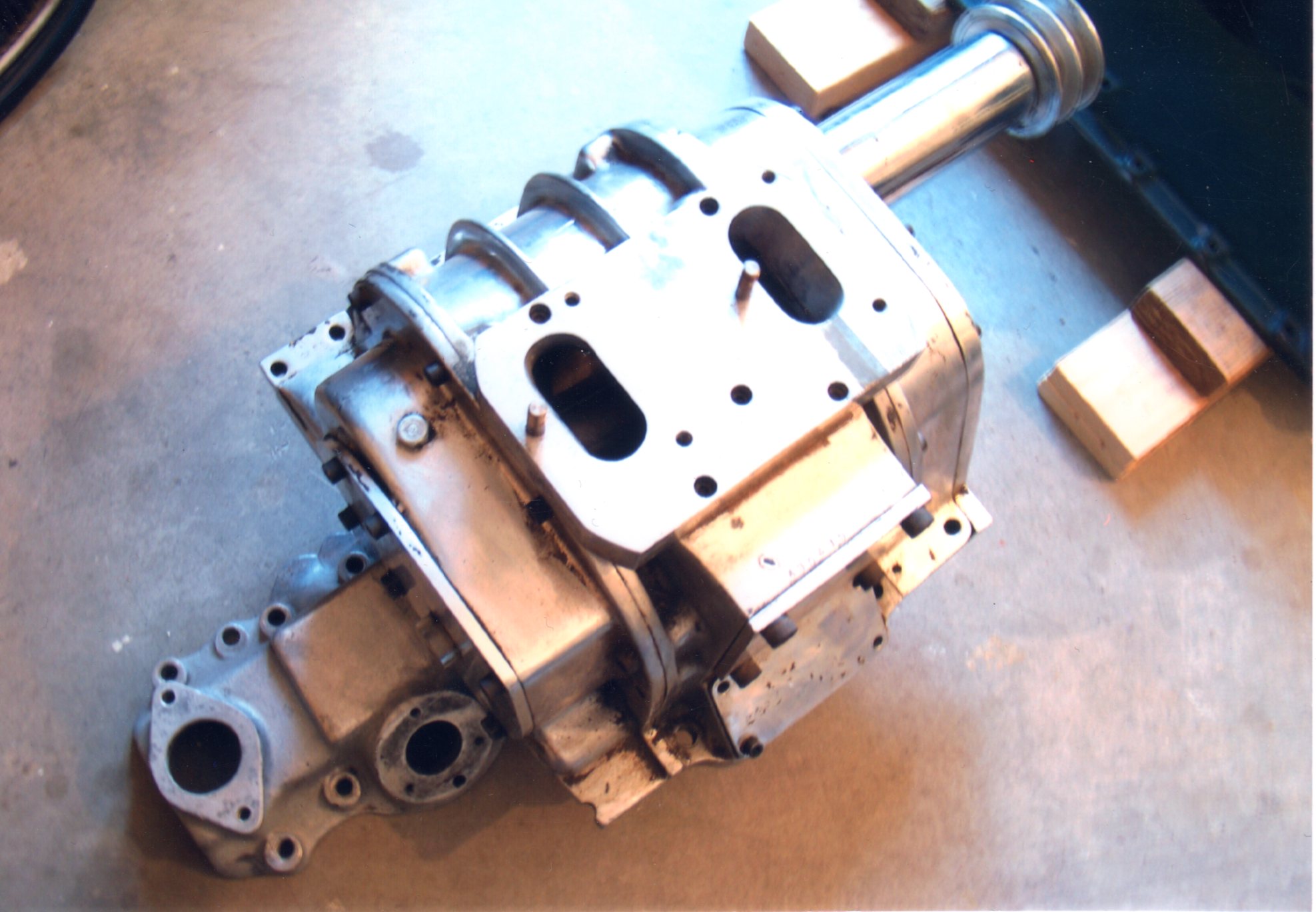

    Can’t ID This?!
    Any of you real knowledgeable
    roots-type supercharger historians
    know the manufacturer and year
    of this blower?
    Or who made the drive?
    Detroit-GMC-Eaton?
    Hamilton-Whitfield?
    Buda?
    Thanks!
    ~David

  2. I don't have a clue,but is that a Flathead intake? HRP
  3. Any measurements? case length? Looks like a GMC 2-71...almost.
    The 2-71 had a side inlet, and was (I think) used on small generators.
    'Just a guess.

    That would be a Detroit Diesel 2-71

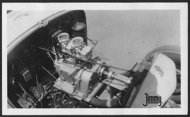

  6. I agree it is a 2/71. Here is one in use in the early 50s

    That's a very cool piece. Is that a provision for a blowoff valve on the intake?

    my first thought was 2-71 as well
  9. I wanted to say a 1-71 just to be a smart ass, Oh did I just say that out loud? :D :D
    2-71 would be correct or if not a damned good copy of one. There should be some markings as to who built the drive and or rear plate unless it is a one off made in someone's machine shop.
